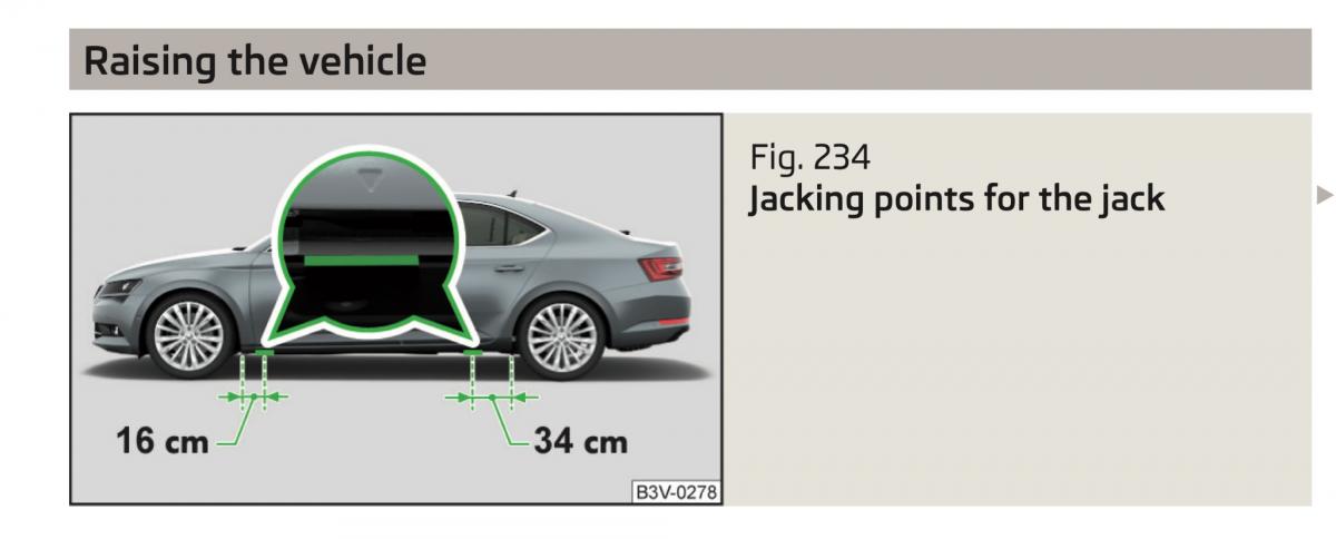

In preparation for getting my new car and swapping wheels around, where are the correct points for jacking using a trolley jack, anyone have an image or photos?

Probably wrong but when I change the summer/winter wheels (twice since new) I use a trolley jack protected by a wood insert on the normal jacking points which are obvious to the untrained eye if you look along the sill.
Take a look here :-)
cheers for the images, similar to my old Mondeo then, I'll use my hockey puck with the trolley jack.
