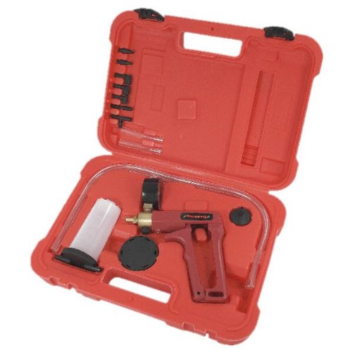

Got one of these and a bit of copper grease. Hand held vacuum pump - Made by Nielsen. Attach pipes at the wheel. Grease round the nipple thread. Top up the cars fluid reservoir and suck it through. No positive pressue and the vacuum helps hold the pipe on so no risk of fluid blast and no unattended pipe full of break fluid running near my paintwork. Suits me a lot better, cost slightly less than a new easy bleed at a popular web shopping site.

Edit:- I've got a mityvac thing as well for - maybe something else.
