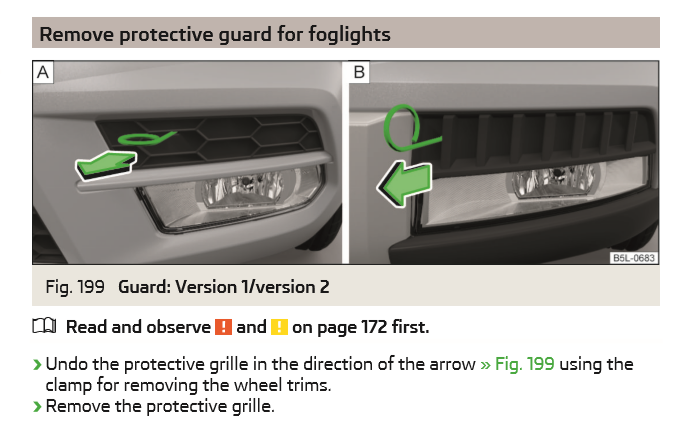

If think they are there are they a metal ring with a hook on the end
That is the tool to remove wheel covers if alloys are not fitted and the trim below the fog lights, you'll probably damage the wheels if used to remove the wheel nut covers.
The metal ring with hook is used to remove the fog light trim .
Are these tools the same for All VAG group vehicles as looking on eBay they run from a couple of quid for vw ones to a fiver for ones for Skoda's.

Wheel nut cover remover (if you have covers on the wheel nuts) looks like this .

I know the metal wire hook is also found in the VW Touran. It is used for removing the real light cluster.
