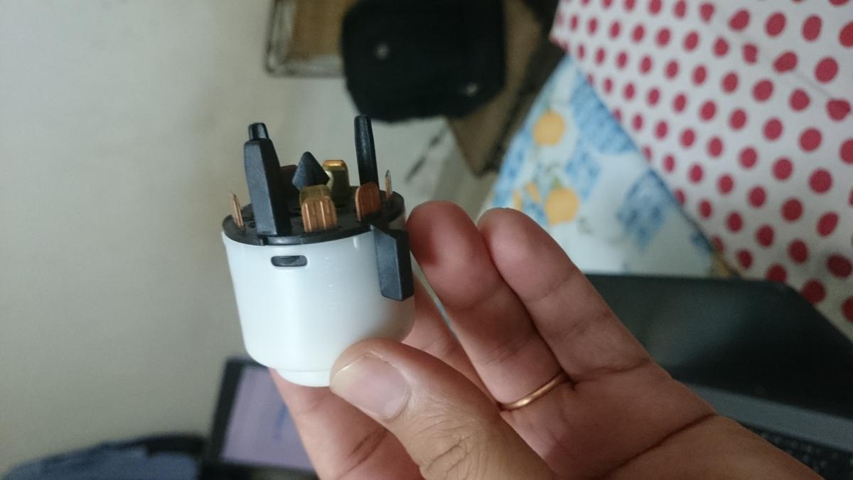

Hi All,
I got it diagnosed by Car electrician, and according to him the problem is lying in the ignition switch and the starter motor itself is okey.
So now as per conveyed by mechanic the problem is either in the Ignition coupler or ignition switch.
And if ignition switch is faulty then its repair is very expensive otherwise coupler is approx Rs 2000 for Fabia.
Any one any suggesion here  or have some idea abot the expenses ?
Thanks,
Chirag
Hi All,
I git this rectified, in my case the problem was the ignition coupler only so it is now up and running fine so far.

  • Sponsor
What does an ignition coupler look like? I've never heard of one?  Unless that's a term for the starter motor solenoid?

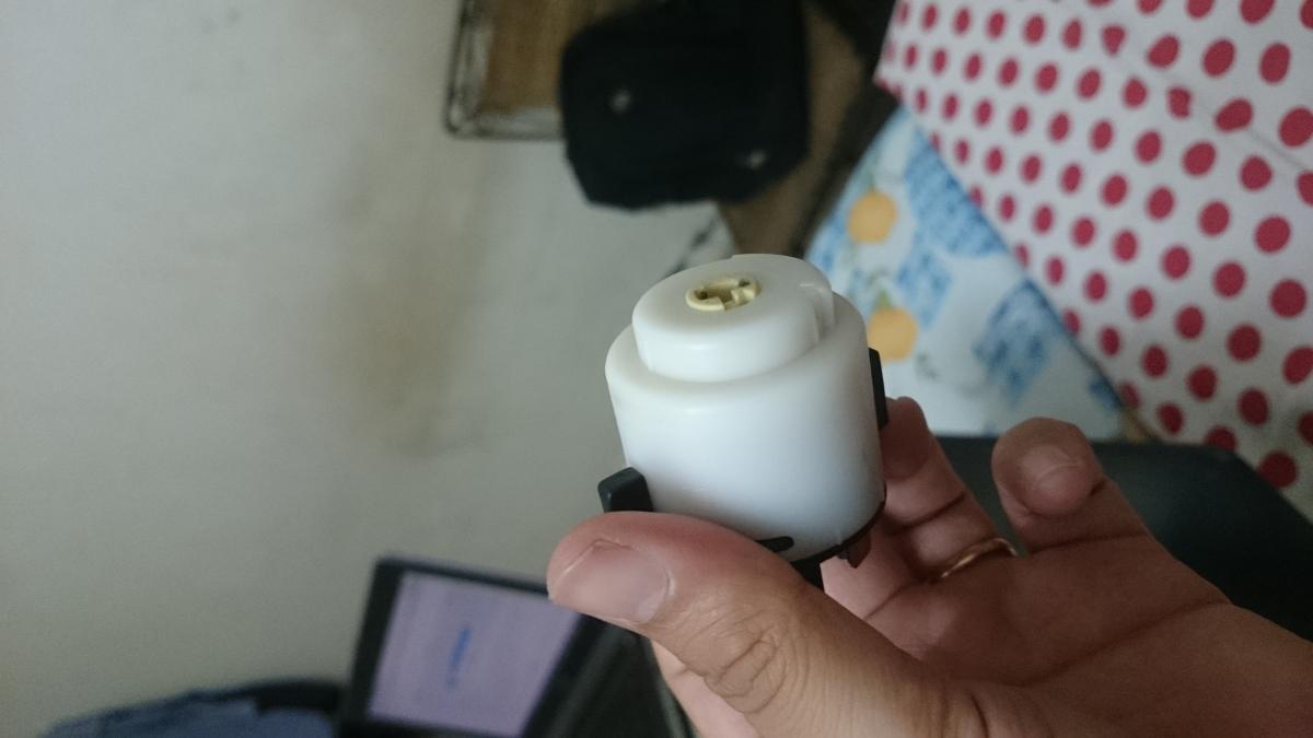

Yes.
Attached is the faulty ignition coupler which was changed.
Edited by Chirag
Yes.
No to me it is not starter motor solenoid though i am not sure.
  • Sponsor
That's the ignition switch, I think.
Yep, part number 5 here.  That may not be exactly the same part number, but I think it's the same functionally.
Thanks for letting us know what the problem was. :)
Edited by Wino
