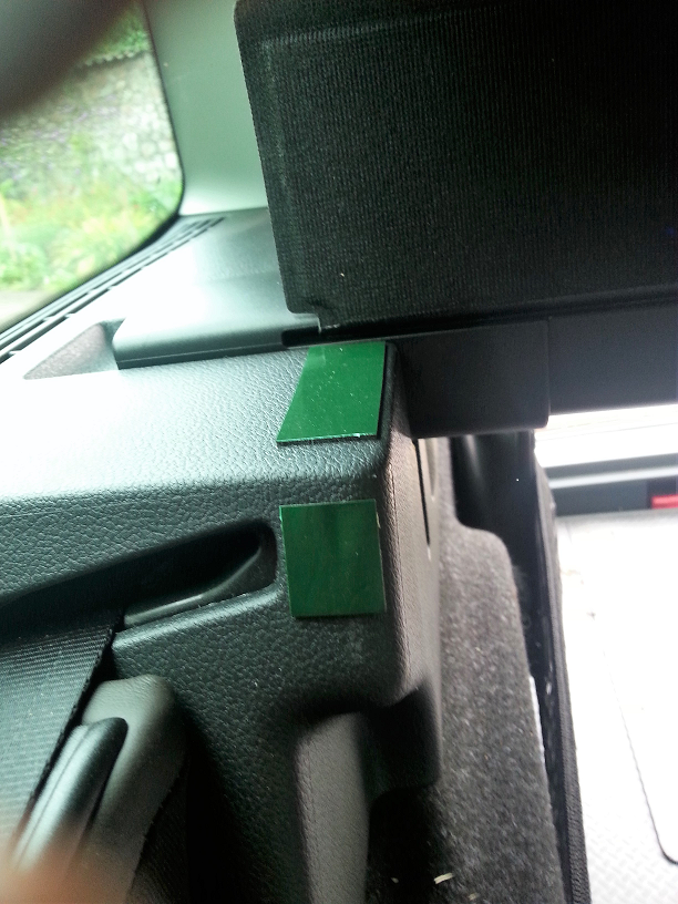

I have had 2 minor rattles both of which I have solved. One was the boot cover touching against some hard plastic and the flap on the inner end rattling against the rear of the seats, sorted that with some judicious pieces of tape.
Please tell us more!  I've spent ages trying to eliminate an intermittent tapping noise from the load cover but haven't had any luck.  Where was it touching and what sort of tape did you use?
See piccie for location. I used a few pieces of padded tape that I had left over. The sort of stuff you can use to fix number plates for example. With the tape in place then make sure you have the lip of the boot cover tucked in behind the rear seats and bingo.
Excuse the rough and ready; I will replace the tape with something a little less conspicuous now I know it works.
Thanks for that, mine rattles worse when I have rear seat passengers so could well be the same thing. I'll try some Velcro loop tape where you've shown.
Sad to say, it hasn't made any difference at all :(
