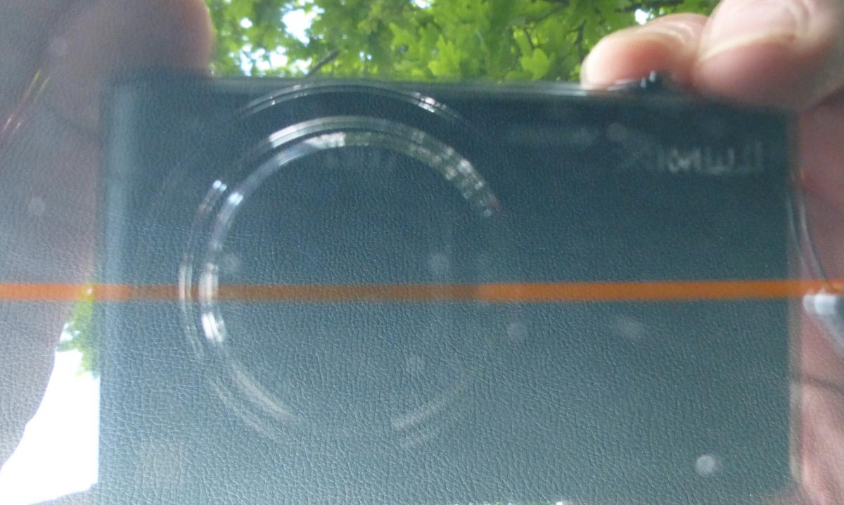

I recently noticed that the elements in the heated rear window seemed a different colour in a few positions (a light orange colour rather than the brighter orange).  The faults vary in length from about half an inch to a quarter of an inch along the element lengths in 4 different places.  I used the heated window last weekend for the first time in many months and noticed that whilst it cleared fully, it didn't seem to clear evenly.

The rear window on our Fabia III was also faulty as described in the original posting - no scratches or other damage, just a bit different colour on part of the element.
It was replaced by Skoda as a warrantee repair.
I think it was a manufacturing problem.post-10862-0-99865300-1475067175_thumb.jpg
