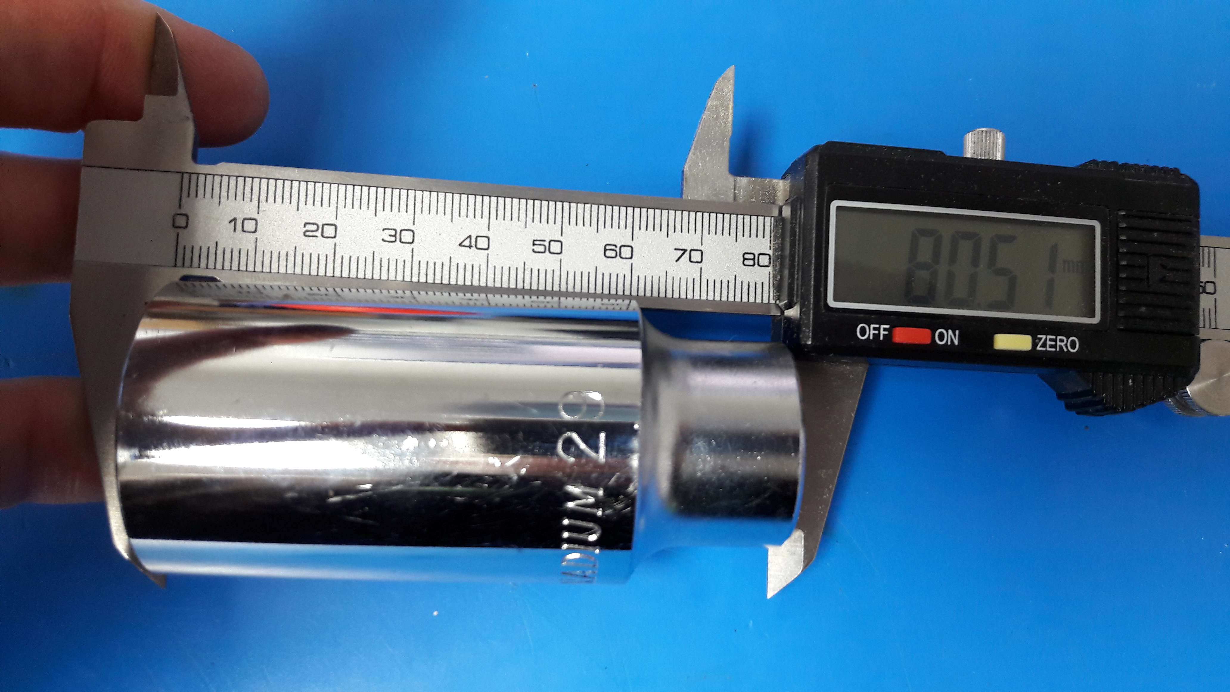

OK. Overall about 80mm:

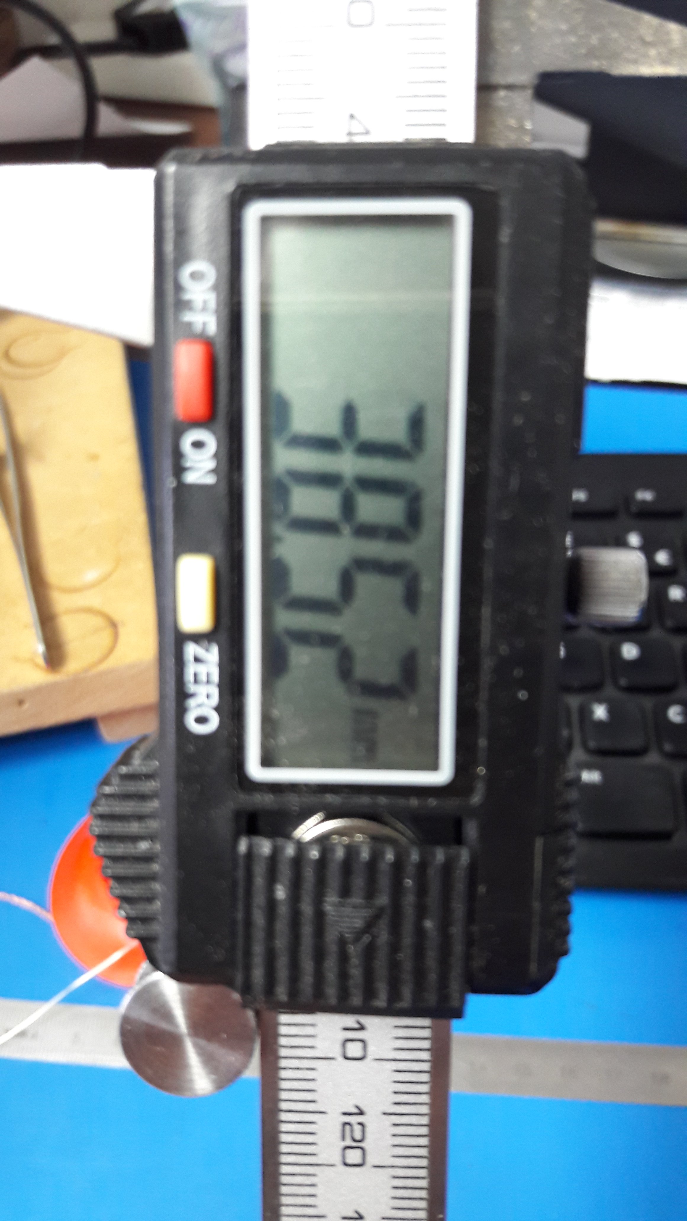

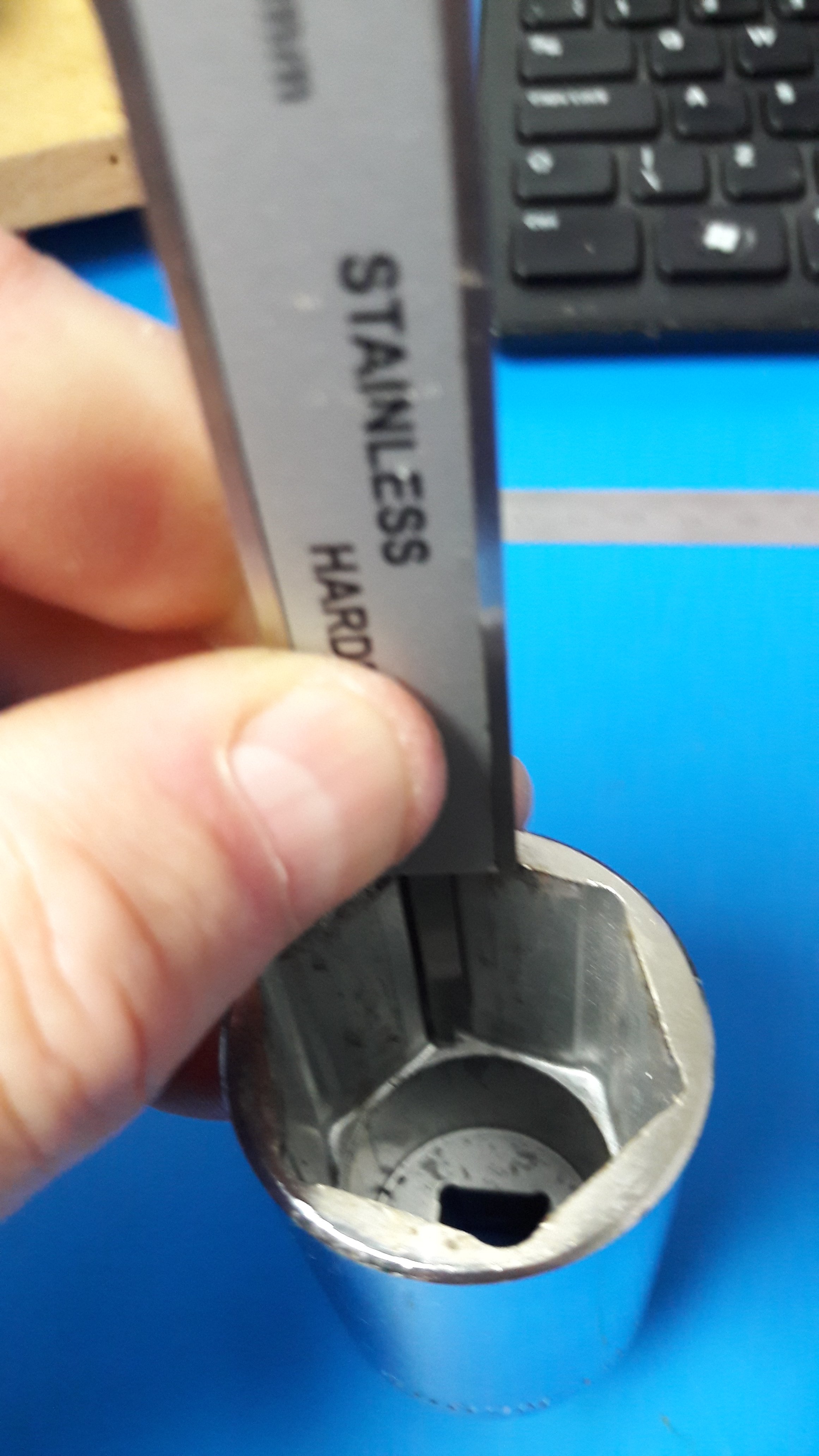

But that's not the important dimension.  You need the internal length to be at least (preferably a little more) than this one:

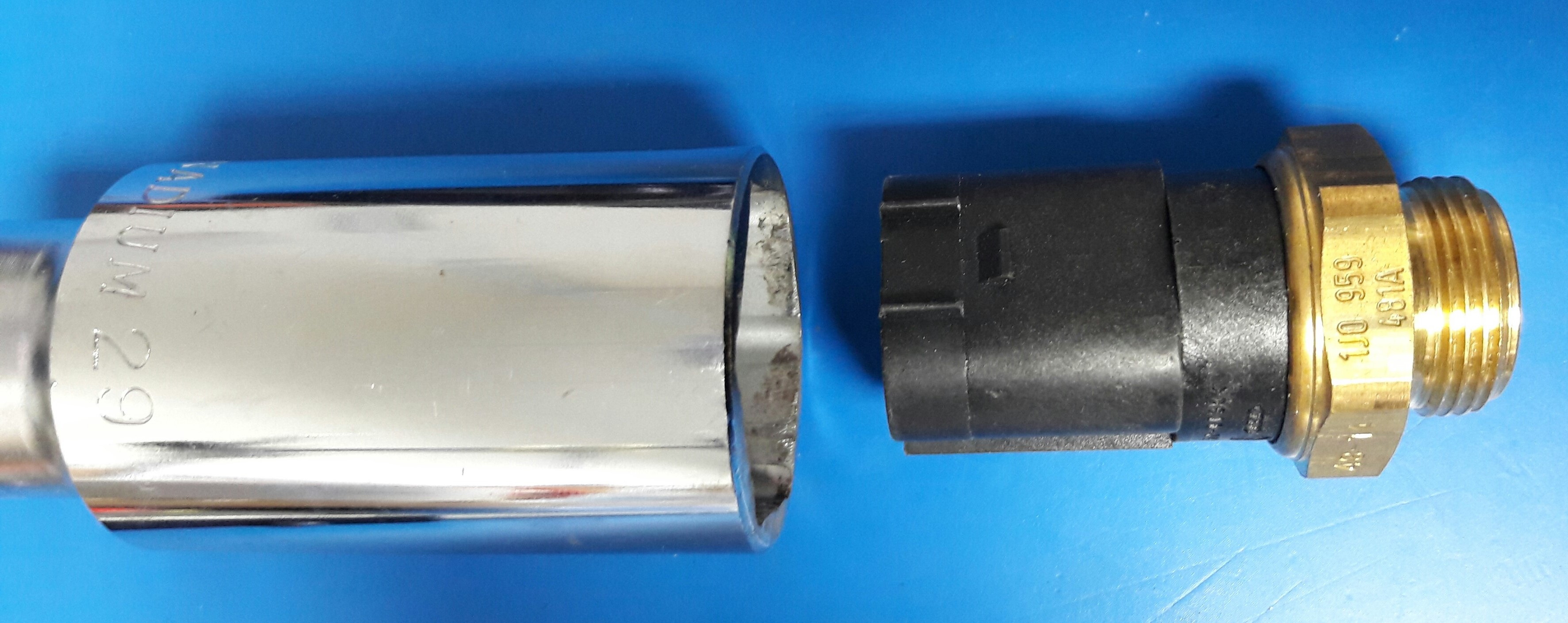

The reason you need that 38.5mm+ is that he connector part of the thermoswitch is quite long:
In fact this socket is only just engaging enough:

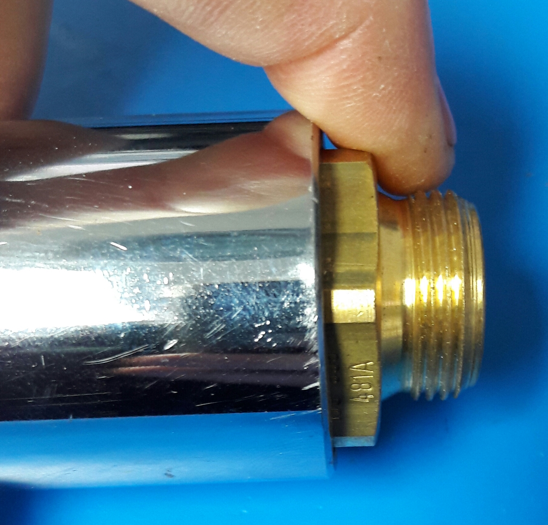

So it's 1 1/8" AF then, plumbing and pipe fittings are commonly imperial sizes.
