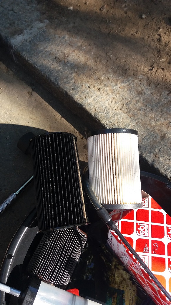

I'v tried to upload some photos of the filter's and process I used to change oil, filter and fuel filter but can't see where to add photo's.
All has gone well anyway. I put a tin of Liqui Moly in the fuel filter instead of diesel, fitted the new rubber ring and closed it.

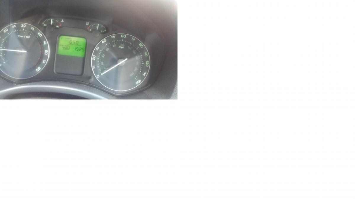

post-142440-0-72403300-1476128640_thumb.jpgHi all,
This post is over though I wanted to share the photo of my now mileage. Brilliant. This was on a 160 mile run after I'd changed oil &filter, New fuel filter and liquid cleaned the injections by both, filling up the new fuel filter with liqui moly and a wynns cleaner in the tank.
I had blasted it before, about a week ago once I'd serviced. But now 65 mpg while doing 70 ish in cruse control - for most of the time - M & A/B roads, is great.
Thanks again. :nerd:
