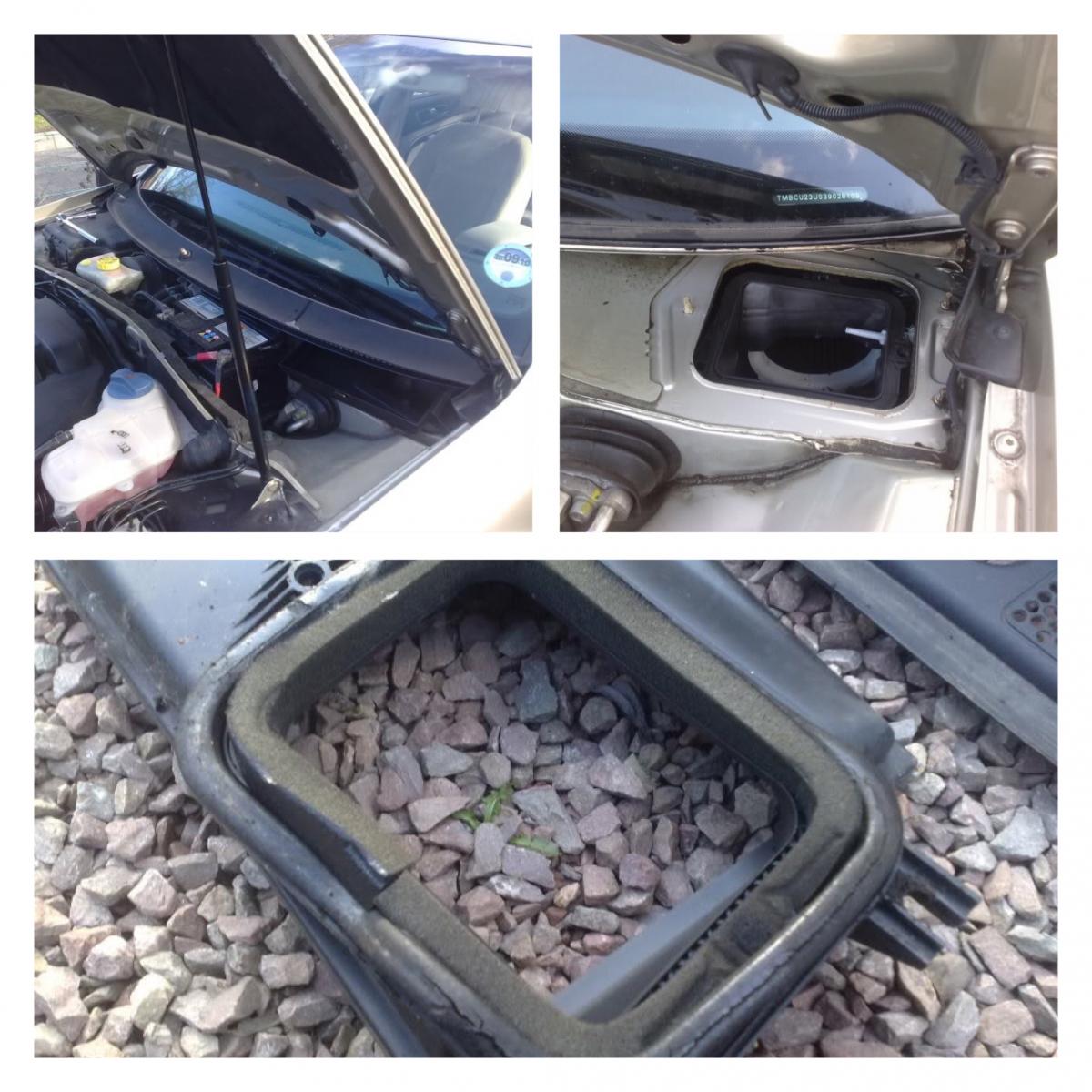

Hi All,
Looking for some advice.
I appreciate this may have been asked before but I haven't been able to find a forum response to it.
I am looking for a link to where I can buy the new design replacement (Closed as opposed to open foam) Pollen Filter seal.
Also any advise on what to use as a sealant to seal the Pollen filter to the car body.
Ben
Thanks Lymington.
Is there a site to just buy the seal or do you have to buy the whole unit?
It's more usual to unbolt the housing, take out the old foam seal, clean up the plastic housing and paintwork, then use a silicone-type cartridge sealant before bolting it back together.
Though I understand it is possible to buy a modified foam from your friendly Skoda or VAG dealer, the silicone sealant option is much cheaper and in my view more likely to be a long term solution.
Edit....here is the info...   http://www.briskoda.net/forums/topic/152490-water-ingress-problemsolved/
Happy reading!
Edited by Tdi1.9
If you buy a new housing it still comes with the old style seal, which will only last a little while before breaking again (the upturned metal lip in the chassis cuts the treated foam surface).
The new style seal from VW is actually a sealing cord made of a butyl rubber type material.  I'd say personally that it is better than silicone; silicone stinks and is messy, and can just give way / let go.  The butyl cord deforms around the lip and is pinched up tight by the bolts.  I can't see how it would ever leak unless it somehow shrank.

Thanks again guys. Do I also need to replace the foam gasket on the Pollen filter? If so, is there a newer replacement which is better than the original? Is there a part number for it?

I bought a new housing as someone had damaged the rain channel.  First thing I did was throw away that foam seal.  The only difference is that it is newer and looks shiny... for now.

I guess if you buy it you could at least then look at it and form a view as to whether it looks a better quality.  But then, while you have it off, why not seal it properly.  Daft not to IMHO.
Gaz
Always used a good quality sealer and been just fine for years. Done so many of these and the associated wiring repairs.
