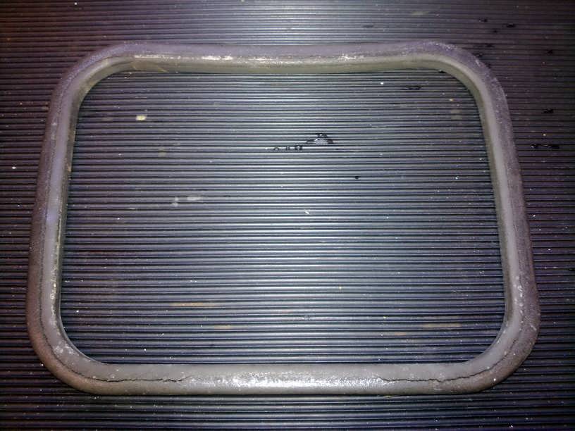

Fudged seal:

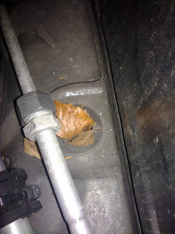

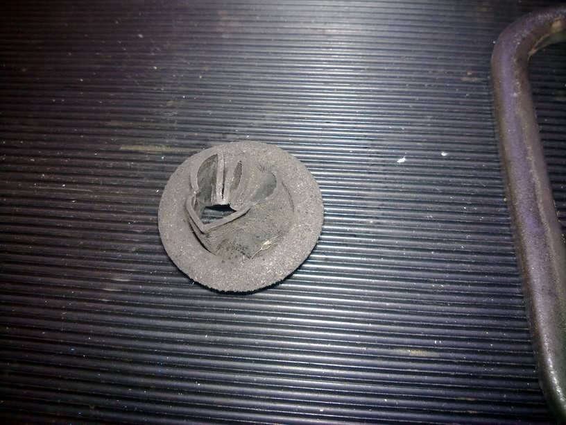

My plenum chamber drains were partially blocked, but thankfully bone dry. One had leaves in it, the other just awash with dust and dirt.
The pollen filter foam seal was partially perished but I doubt had let water in yet. Resealed with half a tube of silicone sealant. With a several interruptions it took a grand total of three hours. If I had to do it again tomorrow, without interruptions I reckon you could halve that time. Annoying though it takes that long to get to the offending parts and only 5 minutes to fix the parts themselves. Speaking of which here is the foam seal and one of the plenum grommets.
