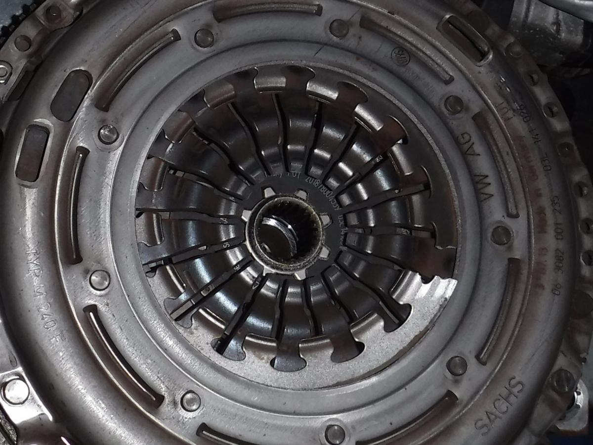

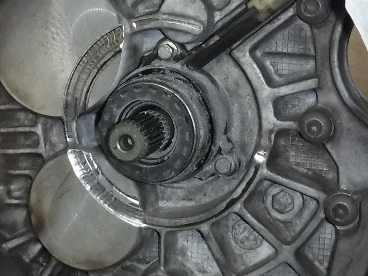

On Monday car was found to be making a worrying rattle/ whirring noise which stopped when clutch pedal was pressed. Have read many horror stories about DMF failure I took it to my local dealer, Henry's, in Glasgow. They checked the car and confirmed a clutch issue and noted they didn't recommend driving in case of further damage. Despite the no notice call they gave me the service manager's car on loan and have arranged to work as fast as they can to resolve. I have an extended warranty with Warrantywise (waiting for response) so the gearbox had to come off to confirm damage. They called yesterday inviting me to inspect the damage - confirmed as failed pressure plate and damage to bell housing.

...confirmed as failed pressure plate and damage to bell housing.

Update:  The parts required identified and warranty direct approved repairs so just waiting on parts to arrive and rebuild to start. The result is a new clutch assembly and a new gearbox casing. Both Henry's and Warranty Direct have been great so far - this lot is costing more than 2 years premium.

This fault occurs when part of the clutch pressure plate breaks off, sticks out and begins to bore through the gearbox casing.
It's normally accompanied by a continuous noise with the engine running.
As James notes it does make a noise BUT it was only heard outside the car or if the windows were opened.
Surprisingly (and worryingly) the noise is just not heard inside the car. It was only by chance I got out with the engine still running and heard the noise. If I had't heard it I suspect the first I'd have known would be the gearbox exploding or dumping it's oil on the road/ driveway. The only other symptom was a slight clutch judder on a cold start shortly before the event
