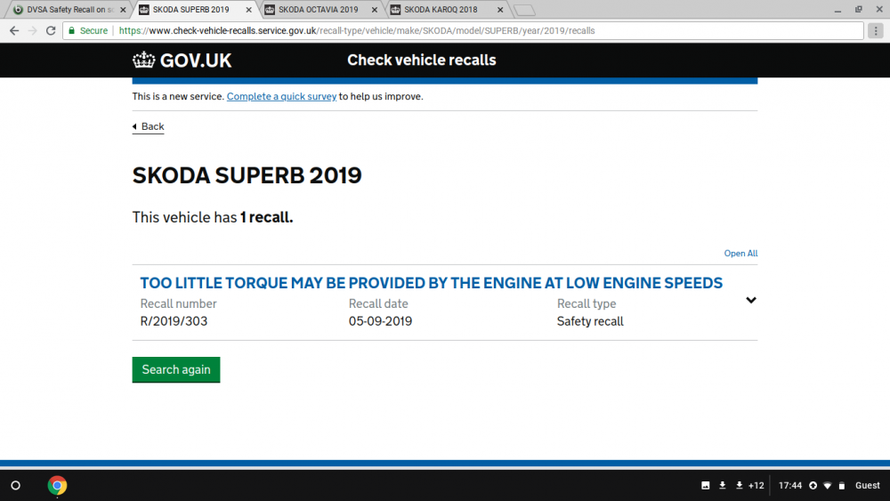

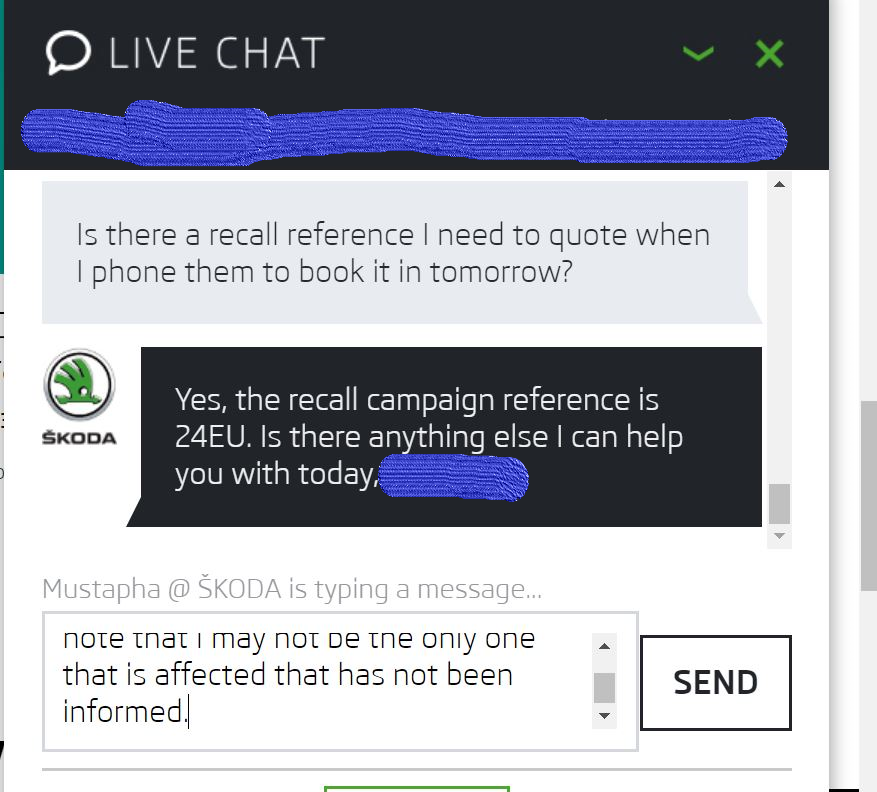

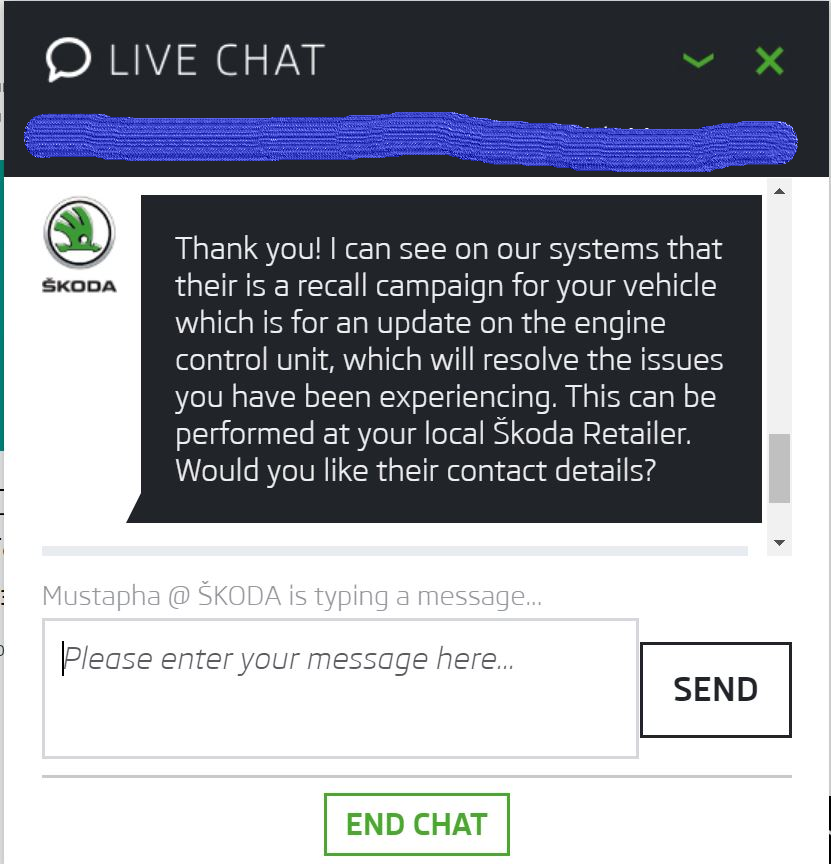

I am having issues with my 19 plate Superb 1.5 TSi with 6 speed manual gearbox. Issues with jumping along in 1st gear when cold and stalling at junctions for no apparent reason. I contacted Skoda this evening and there is a recall campaign 24EU which Skoda or Skoda dealer had not informed me that I needed / was entitled to to fix my car's issues! Very poor service. I have booked my car in via Arnold Clark website for Thursday to hopefully get it sorted. I will report back after1902377393_livechat2141019.thumb.png.6f6e271d1e41563e7dcf050d15e3b7e0.png2048212775_livechat1141019.thumb.png.aa176406578e116848a17cc6d0f414d7.pngwards.

Hi Doug
Has the recall software update that you had done back in October last year rectified the kangarooing and hesitation issues?

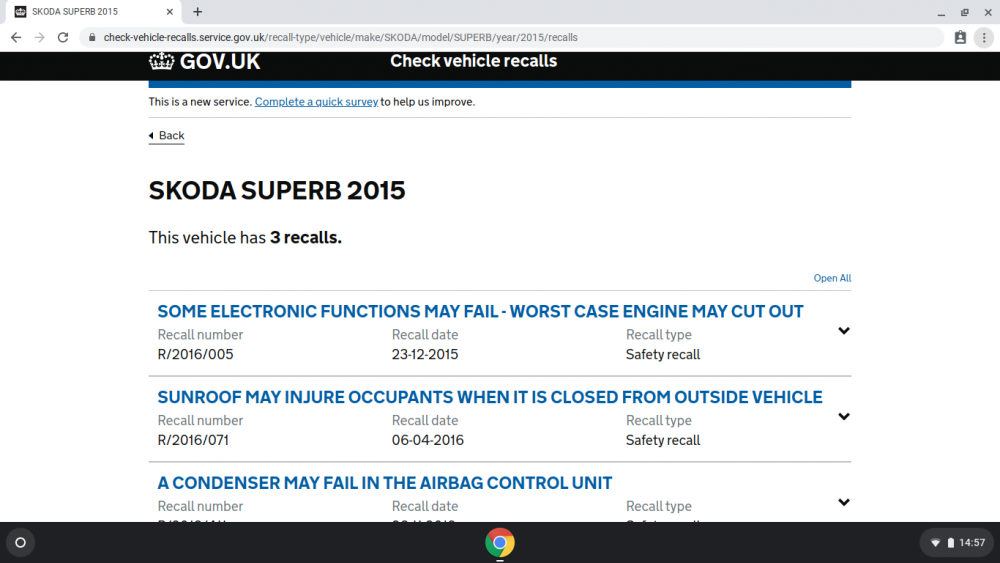

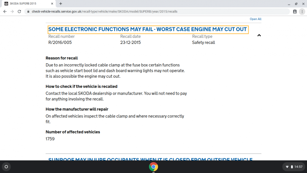

On 09/07/2017 at 10:49, e-Roottoot said:
No but there are recalls on older models in other countries and currently New Builds in Dealerships not being delivered waiting for parts due to failures Recall.
http://master.skoda-auto.com/mini-apps/recall-actions

My car didn't show up on any websites/recall checkers over the last year.
Took car in for it's first 'inspection' and they applied the 1.5 TSI software update. It's now smooth as butter when cold compare to being a bit jumpy
for the first minute or so of cold engine driving.
If only I'd rang the dealer and asked before!
