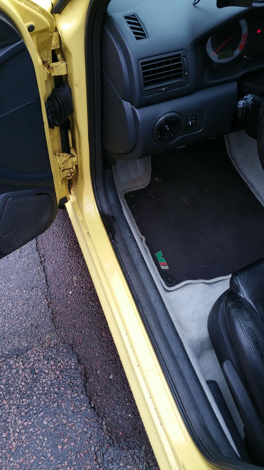

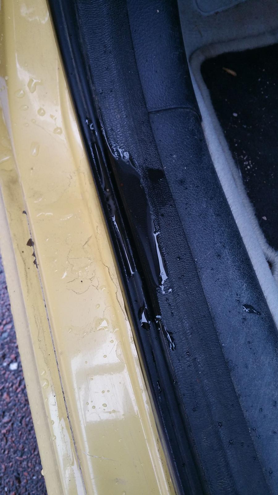

So i discovered yesterday that water had pooled a little bit, but not run down to the mat or anything, so it was essentially just where the pictures show it:
This morning though it'd rained more, so the whole lining was full where it originally pooled and started dribbling down the back of the drivers seat (Im in Sweden, so have left hand drive), easy enough to dry up..
Anyway, this in conjunction with my drivers side automatic lock not working unless i open/close with a key all seems to point towards rain coming through the rubber around the windows I'm assuming.. SO what should i do to stop the leaking first and foremost? We're getting very close to extremely cold weather here, and if the door freezes i may not be able to open it the way it's leaking now.

and yeah, the plastic sheeting behind the door card is the membrane. The water in your pic is suspiciously close to the door speaker, so if that fiddled with or changed at some point odds are it wasnt 100% sealed before the door was put back together.
