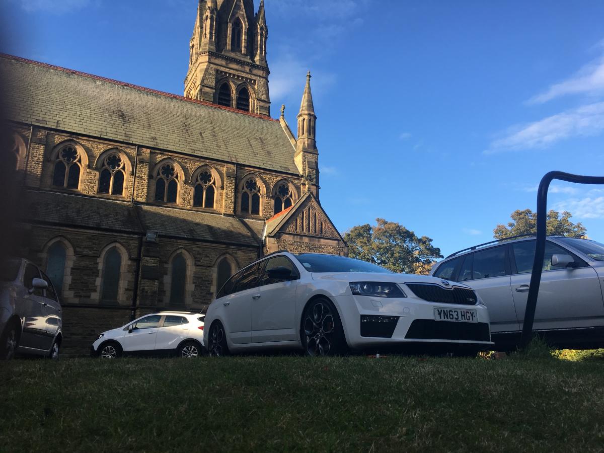

Here's a better pic of mine with 12-12 and lowered with H&R's
Radius seat bolts are fine with OEM wheels. Taper seat are generally for aftermarket wheels. No rubbing whatsoever on mine with 15mm front and 20mm rear.
And you're running 19's?
Looks awesome mate

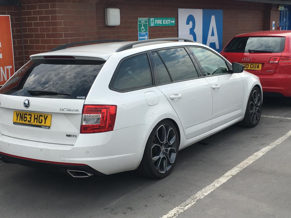

Yep - see link in post #3:
   post-61800-0-15726700-1469708126_thumb.j  post-61800-0-21440100-1469708145_thumb.j
Sorry, not great photos.

Yep, I've got 20mm on the rear and it make a massive difference to the look of the wheels, how 19in get lost in the arches I don't know but they did before the spacers and looked odd.
