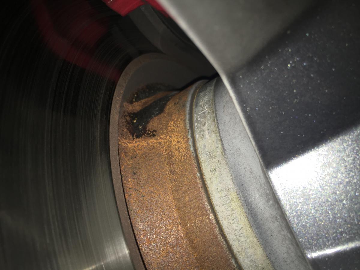

ive got a question regarding wheel spacers, my mate has a set of forge spacers in his shed and whilst my wheels were off the other day we sat them on my car and the diameter of them was smaller than the hub of the disc and the hub of the wheel. I checked online and they are the correct spacers for the car i just didnt like the look of them when you look at the wheels there will be a small gap between the hubs of the wheels and the discs and it wont look very good.
My question is do the eibach or h&r spacers sit the same or are they flush fitting with the hubs, if anyone has any pics of how the spacer sits on the hub that would be fantastic or if you can confirm they sit right ill be happy as this is my next purchase for the car and i want it to look right.
The H&R DEFO do
H&R 12mm front and back
Perfect mate thankyou rhat was just what i was after. Cheers

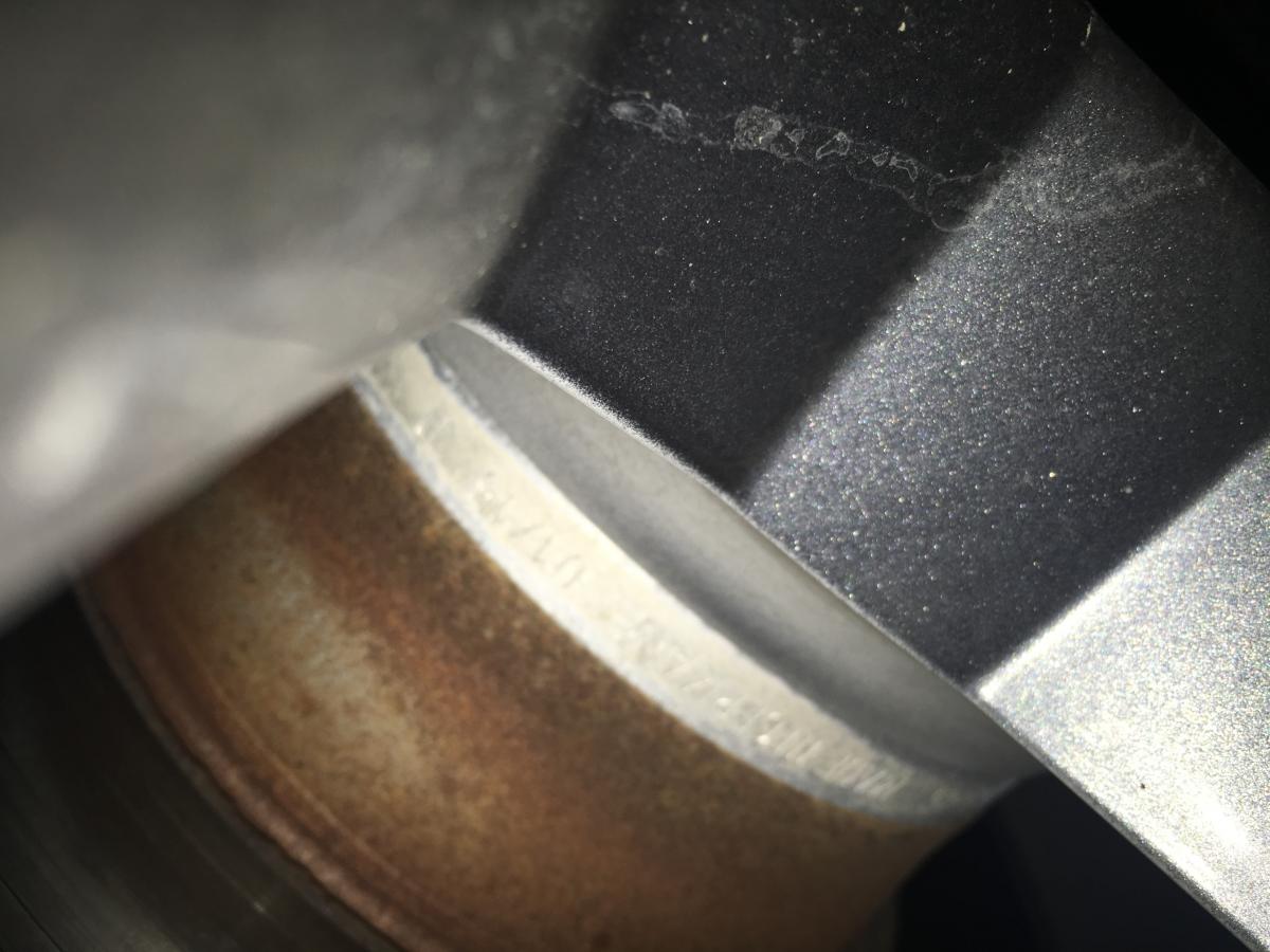

Hi there, is anyone running spacers on their Kodiaq?
I have a 2018 Skoda Kodiaq running 20" wheels, but they are too far in and wanted to push them out flush with the wheel arch.
Anyone recommendations for width/make spacers to go for? Cheers Dave
PIC for attention
@ToffeB3 you will probably have better luck asking in the kodiaq section. Lots round here run spacers though. I have 12 front and 20 rear with extra long bolts for the rears. I think 12mm on the front is the limit for my stock bolts. Whatever you do, go for hubcentric as this holds the spacer and wheel in the correct location. I think much more than 20mm and you'll need bolt on spacers too rather than a disc with holes.
