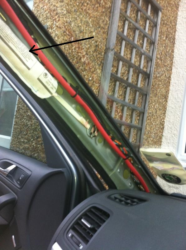

Looks good! and a camera with a very good spec. However, "IF" I am reading your install description correctly? You appear to have run the power cable across the top of the "A" pillar. From the windscreen side of the pillar, to the side where the rubber door seal is. Is this correct?
If you have, then you have very possibly compromised the curtain air bags by crossing the Air bag, which runs partway down that pillar, with the power cable. You might want to re-route it for safety's sake.
Just in case it helps, It is possible to run the cable down the front (by the windscreen) and route the cable through the gap at the base of that pillar. The cable then pops out just to the right of the fuse assembly and behind the fuse assembly door hatch. By routing it thus, you will avoid the cable crossing the air bag.
I have attached a picture of the air bag location for you to see what I am speaking of. My thanks to another member here at Briskoda for the original picture which was used to show the routing of the Panoramic Sun Roof's drain tubes. I hope this helps you and others here................Tony
SORRY! - Just read your signature - You are driving an Octavia. My comments are for the Yeti model and possibly do not apply to the Octavia. However it would be prudent to check the location of the curtain air bag if one is fitted to the Octavia. My apologies for my error.............Tony
I would be very interested to know if the Octavia III has a similar arrangement, as I expect that blocking an airbag would be a very bad idea.
Great Yeti - I would correct to assume that the curtain airbag is the white thing running along the lower edge of the pillar in the photo?
I completely agree that blocking the airbag, in any way! is a seriously bad idea!!
From what I have been able to ascertain. Many new cars have "Curtain Airbags" installed and it is common for them to pass partway down the "A" pillar. A good friend of mine who has fairly recent Octavia tells me his vehicle has just such an arrangement as regards the curtain airbag!
Just for clarification, I have inserted an arrow to show the airbag I was referring to. (The picture is of the Yeti "A" pillar and the airbag in question) Quite clearly, running anything, such as a cable, across the face of the air bag location would potentially compromise it's operation. Were the cable strong enough, whatever was attached to it (camera etc) could quite possibly become a projectile hazard in the event that the air bag should deploy. Being yet another reason NOT to route cables across this location! Anyone who has been fortunate to watch, in person, as I have, the testing of air bags. Will readily tell you of the explosive force which is generated, and that it is not to be underestimated!.
Thanks both.  I fear you're correct.  In previous VAG cars that I've used with an airbag in the A pillar, there's an 'AIRBAG' badge on the pillar... but looking in the A7 Octavia manual last night, it looks like the 'head airbag system' runs like a curtain from midway up the A-pillar across the top of the windows all the way to the C-pillar (pages 18 and 19 for those who want to check).
The notes in the manual explain that the head airbag system is present if there is an AIRBAG badge at the top of the B-pillar, which is indeed the case on my car. :(
So I'll definitely need to reroute the cable - hopefully down the windscreen edge down the side of the A-pillar, then across the bottom next to the dash (rather than crossing the top of the A-pillar).
Thanks again for the tip.  I agree that putting something in the way of an airbag is a very bad idea - both because it'll potentially compromise the effectiveness of the airbag and because you might end up with a wire forcefully thrust into your head, if god forbid it ever activates.

Just wanted to thank Great Yeti and Elbow for the air-bag advice again. I've now re-routed the cable down the edge of the windscreen and via the (very tight!) gap between the side of the dash and the bottom of the a-pillar. The wire is still hidden away, so I'm happy.
I didn't remove the a-pillar trim completely, but used a trim tool to move the trim enough to have a peek inside the top... the white concertina-folds of the airbag were clearly visible going several inches down the top of the a-pillar, so it was definitely a good shout to avoid routing accessory cables over that area!
