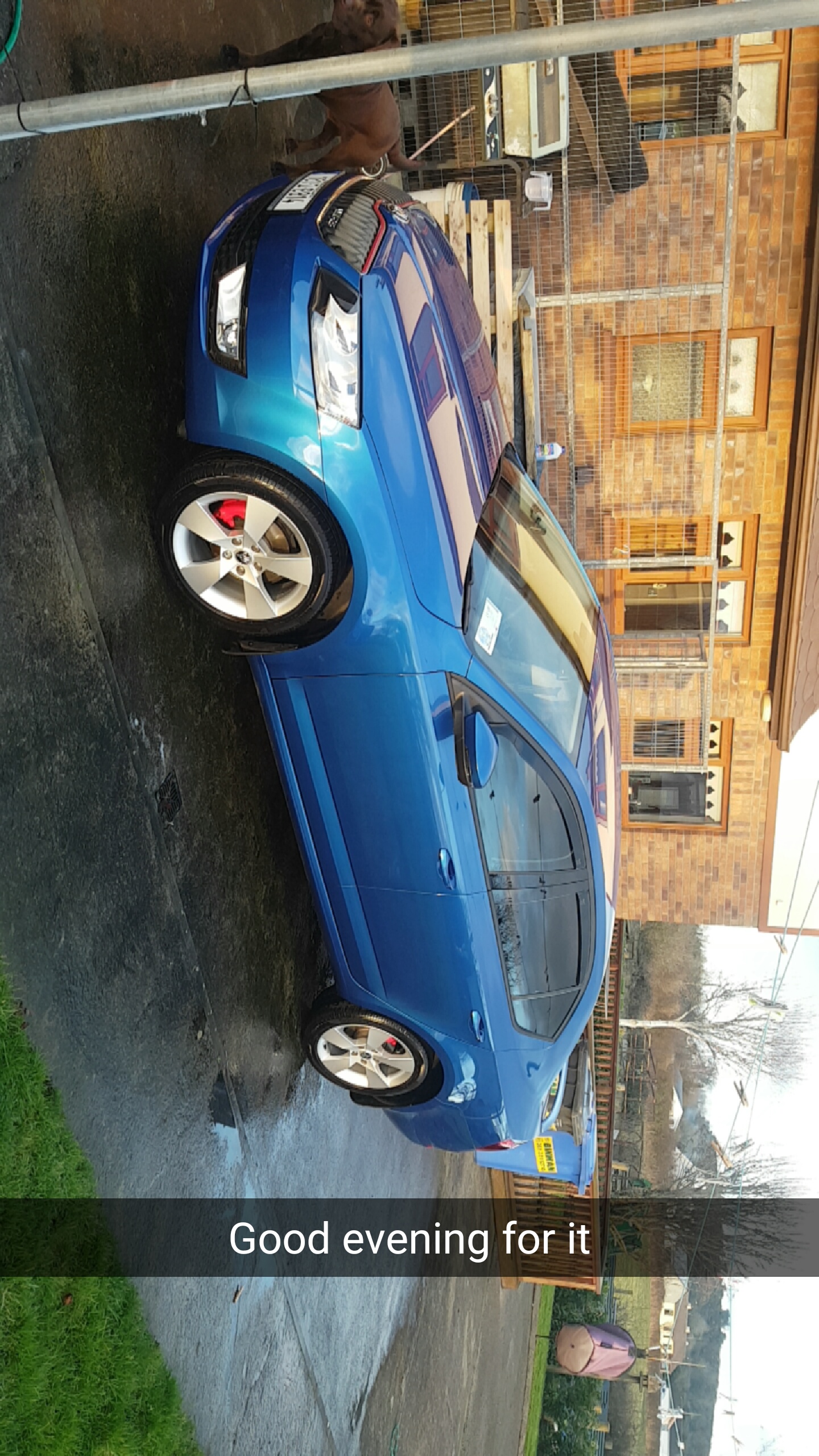

Been a while but wanted to post pic of my Octavia elegance -vrs replica
