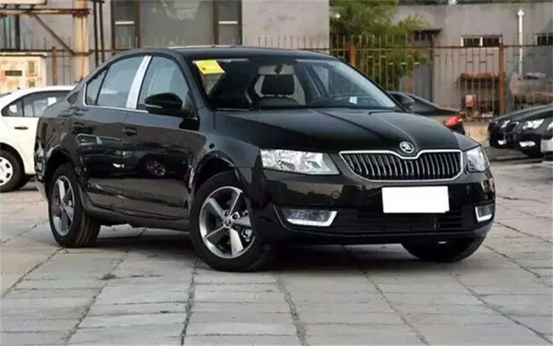

And while I was looking found these rather interesting fog lamps with LED DRL and turn signals built in:
https://www.aliexpress.com/item/LED-fog-lamps-assembly-for-Skoda-Octavia-A7-2014-2015-Daytime-running-light-with-yellow-turning/32755443602.html
HTB15EHSNVXXXXaLXFXXq6xXFXXXs.jpg?size=9
