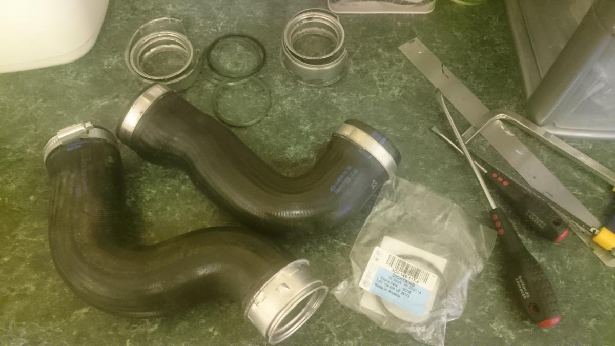

You can modify your existing boost pipes to fit, just carefully cut off the bayonet connector from the intercooler end of each pipe, and use jubilee clips to fasten.

As already said, cut off the bayonet fitting with the O-ring and use a clamp.  If you are using jubilee clips then try and fit two.
