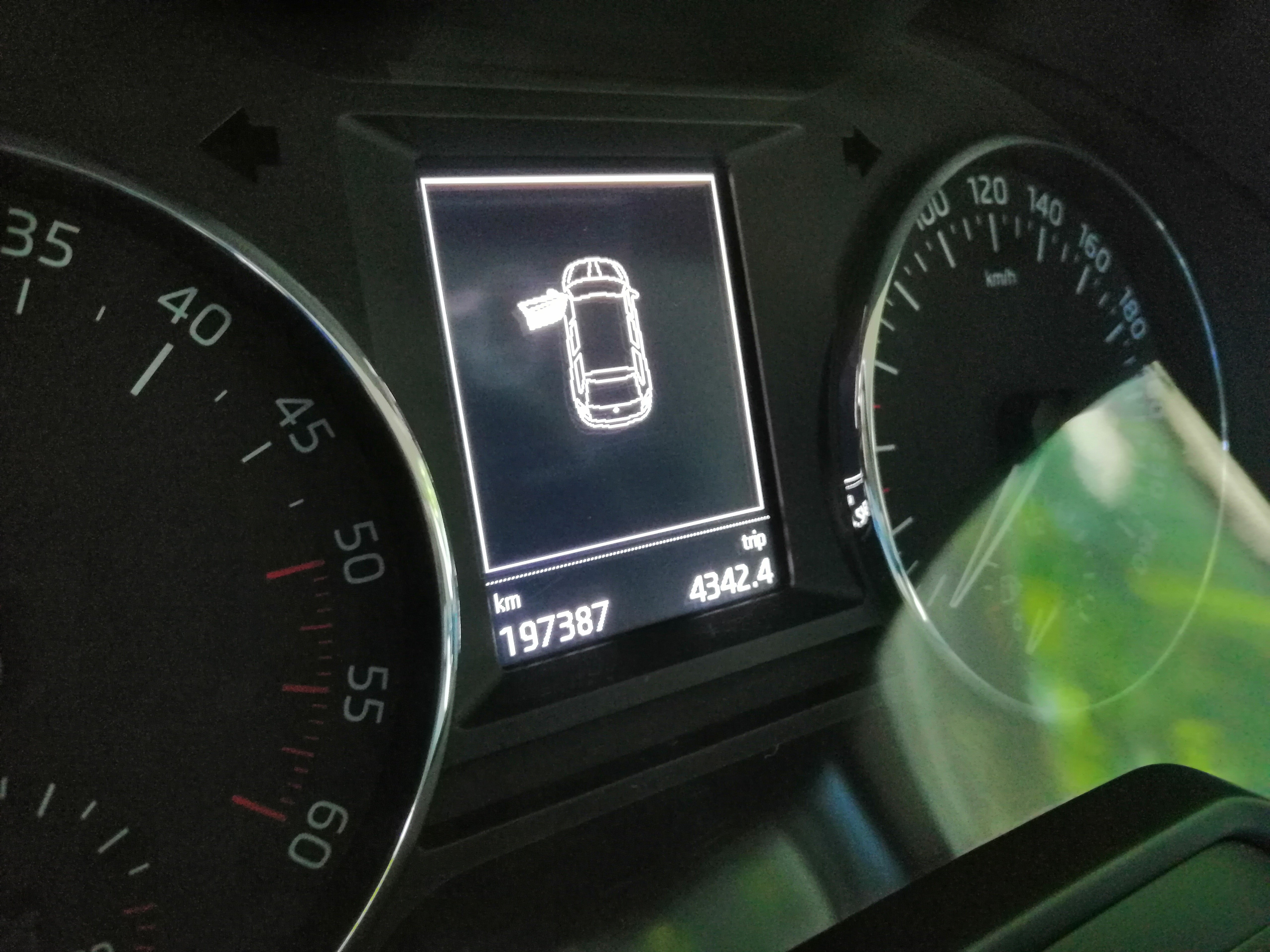

On my previous octavia (now my wifes) i've had that same noise for almost 200.000 kms now. Been to the service 3 times for that and they said its normal..
Thanks for the info to know its not "normal" though i wont be changing it now as its out of warranty..

Hi.
Have the noise increased over time? If the noise just stay the same as now - then I can abstract from it. But if it gets worse - then I have to think about it.
Its about the same.
Its been present from the new till today (pic)
