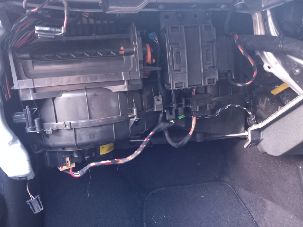

What should I be removing? Any help much appreciated.
It's a 2014 skoda superb I have
You have done the fiddly bit (removing the glove box)!
The video (turn the volume down if you don't speak Polish) shows how to remove the fan, which is very straightforward:
See what I have to do now, ggood video.
