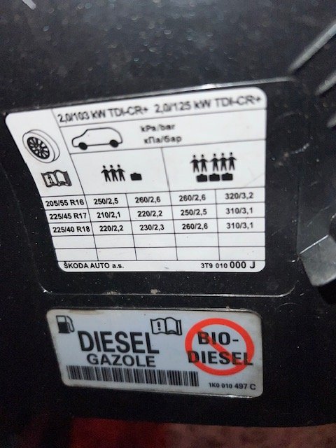

  15. Not sure where you got that from, but in the real world, most people will get the tyre pressure data from the sticker on the fuel cap, as below. Not so clear, is it?
