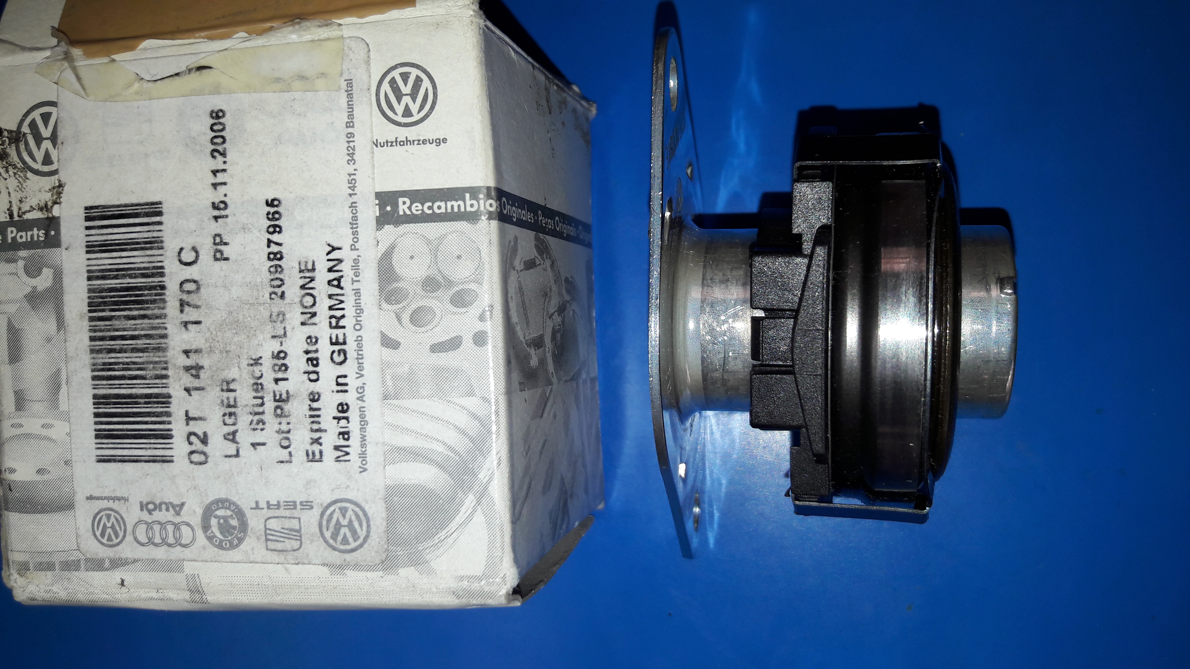

Yeah, but you can also get just the bearing plus guide as item 7, 02T141170C, which I did, along with the friction disc and pressure plate (pictured in an earlier post) via ebay. Before I knew about the possible need for the lever bit.
I guess for extreme preparedness, I ought to have the input shaft seal, item 11 on that page (defined as item 11 on this page) too?
Bearing I bought:

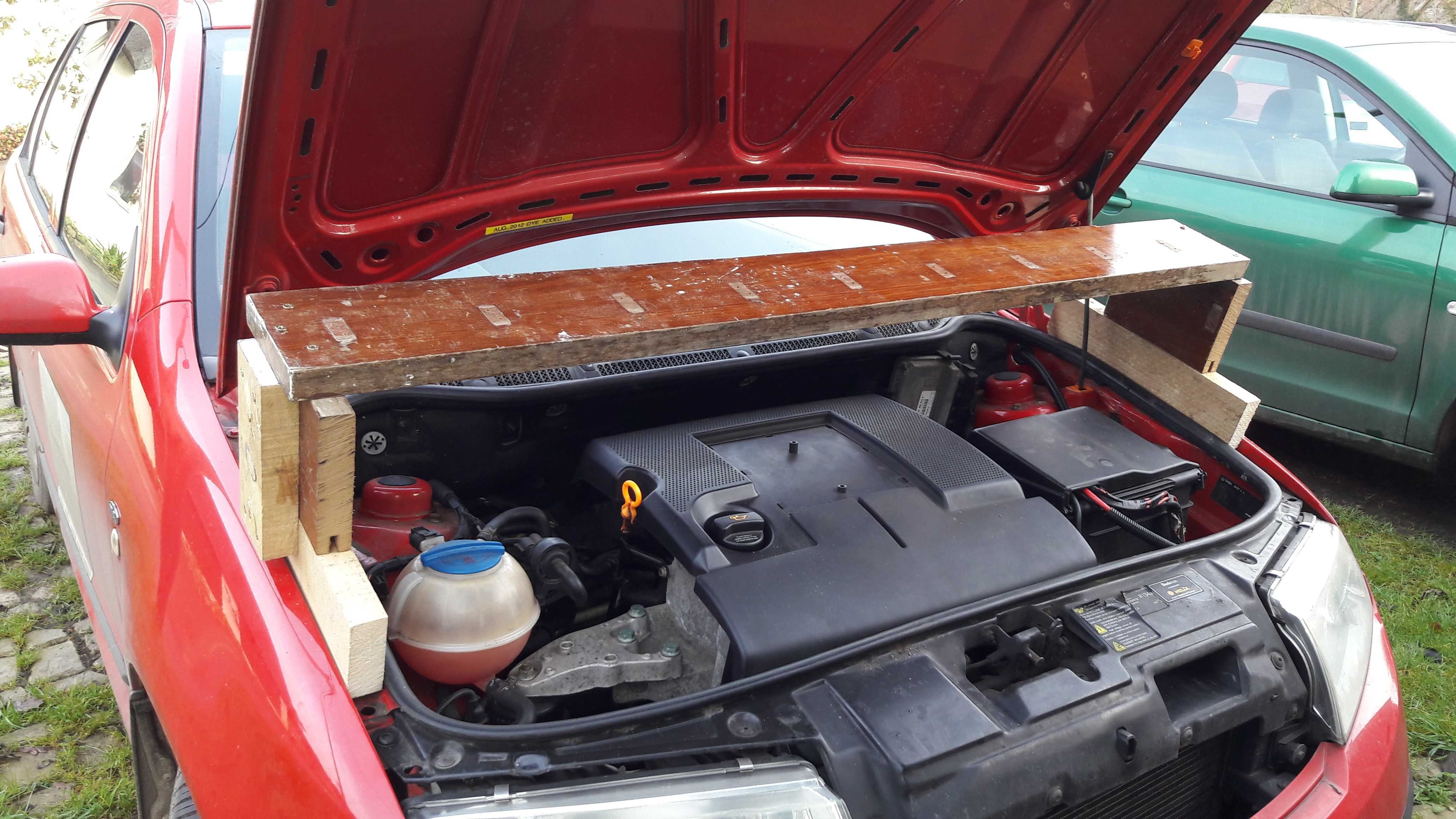

My zero-cost engine/gearbox support.  It will gain a multipurchase block-and-tackle arrangement for fine-tuning the height of the gearbox, borrowed from a sailboat.
The crossbeam is some sort of hardwood, and barely deflects when I stand in the middle, and I'm not 8 stone...  It's higher than it probably needs to be, but that gives more room under it for pulley systems and spannering.
If I'm feeling particularly cautious, I may add some triangulation under the ends.
Bodgetastic or what?

^ I like it, Pete :D

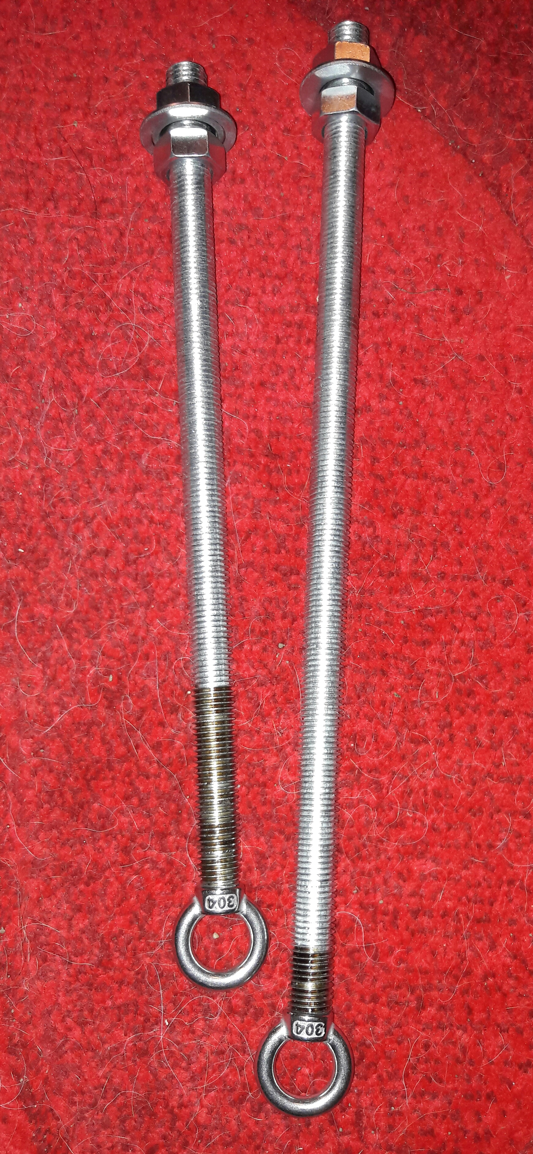

I just use a 2x2 steel box section with a couple of hole's in it  and 2 blocks of wood to sit it on the inner wing rails, and have a big section of 16mm allthread with a D link welded to it so I can lift or drop as required, I use it for clutches or cambelts depending which end needs supporting lol

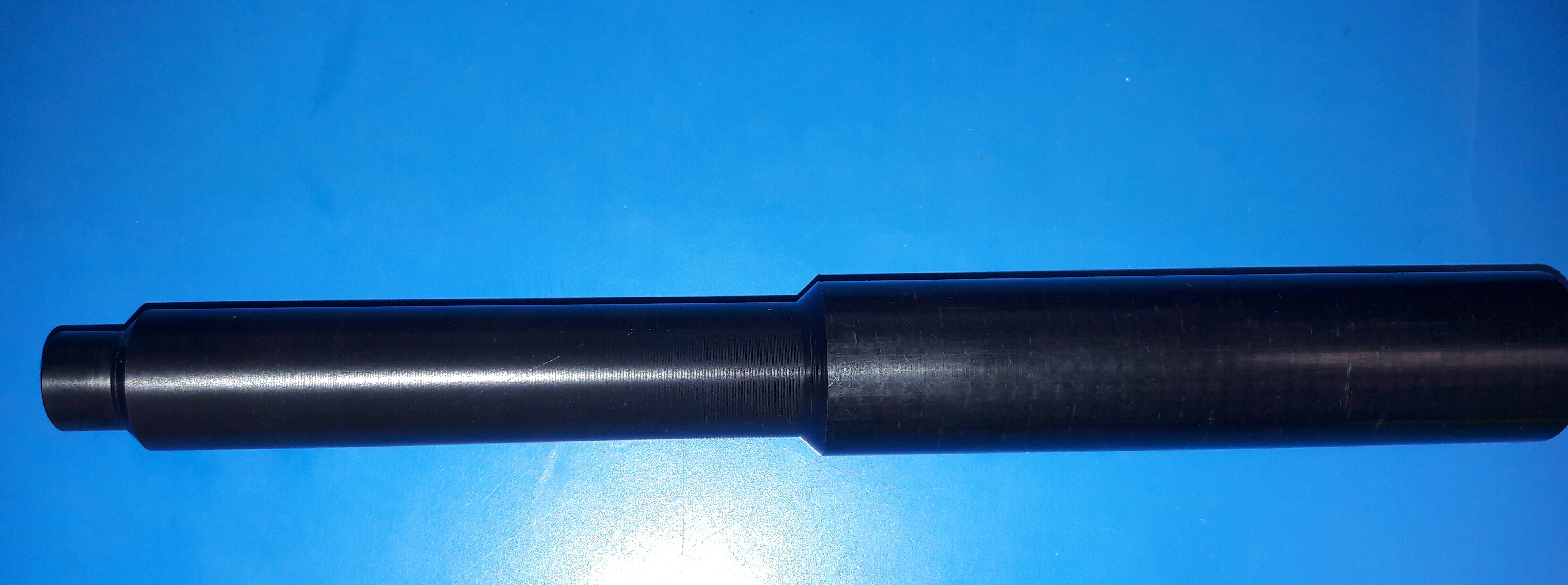

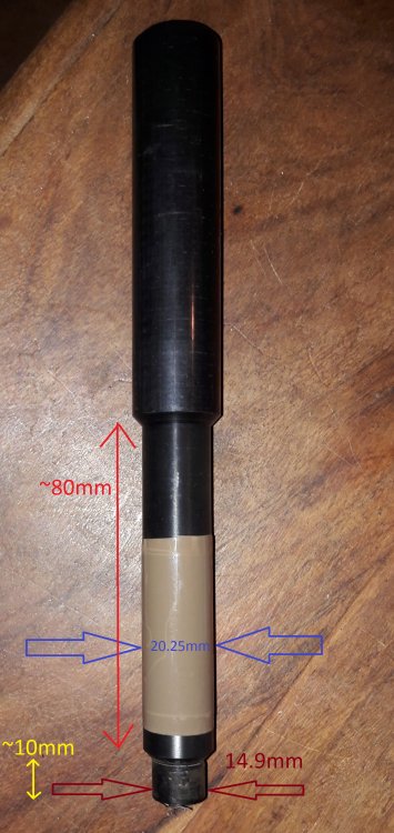

Alignment tool knocked up this lunchtime by a friend with a lathe.  Measured what the larger diameter needed to be off the friction disc, then scaled off a google photo of the genuine tool to get the smaller diameter.  (Then knocked a bit off the former and a bit more off the latter for 'elbow room' that can be adjusted upwards with tape if/as required).
Seemed like a cunning plan, so I copied it.  I don't weld, but I found M16 studding, nuts & washers 'around' and some M8 eyebolts.  Bit of drilling and tapping up the ends of the studding later...
I'll hold off drilling the holes in my crossbeam 'til the bay's a bit stripped down and the best locations are clearer.  :)

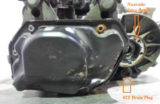

02 box- same as mine ? I don't remember Ally & mate using anything to lift /support engine . Gearbox drain/fill plug - found out past few days ( the hard way, or rather SIL did ) that the drain plug is on rear of box and the plug is a massive hex key,( very close to where you'd expect engine drain to be :sweat: ). Filler is on front of box, again massive hex key, but I'd suggest a plastic bottle with a "swan neck" or using a long tube from above to fill the box,as the fill plug is awkward. I've never had any problems using anything other than a a socket extension bar to align a clutch ( other than on my mates Estell) where it was a case of leaving the clutch plate floating, then fit engine and then (using a small socket set ,lock plate into position). But then , even getting the drive shafts out was a major operation.
Oil ,BTW, is 75 Synthetic ,all 2 Litre of it.
  • Sponsor
This has an 02T box, yours is 02R I think. Fill/drain plugs use 17mm male hex tool which I have. Locations sound quite different though.

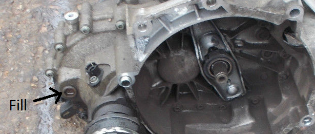

Fill plug's here, drain more or less opposite on t'other side of diff, lower down, more under the driveshaft than alongside:

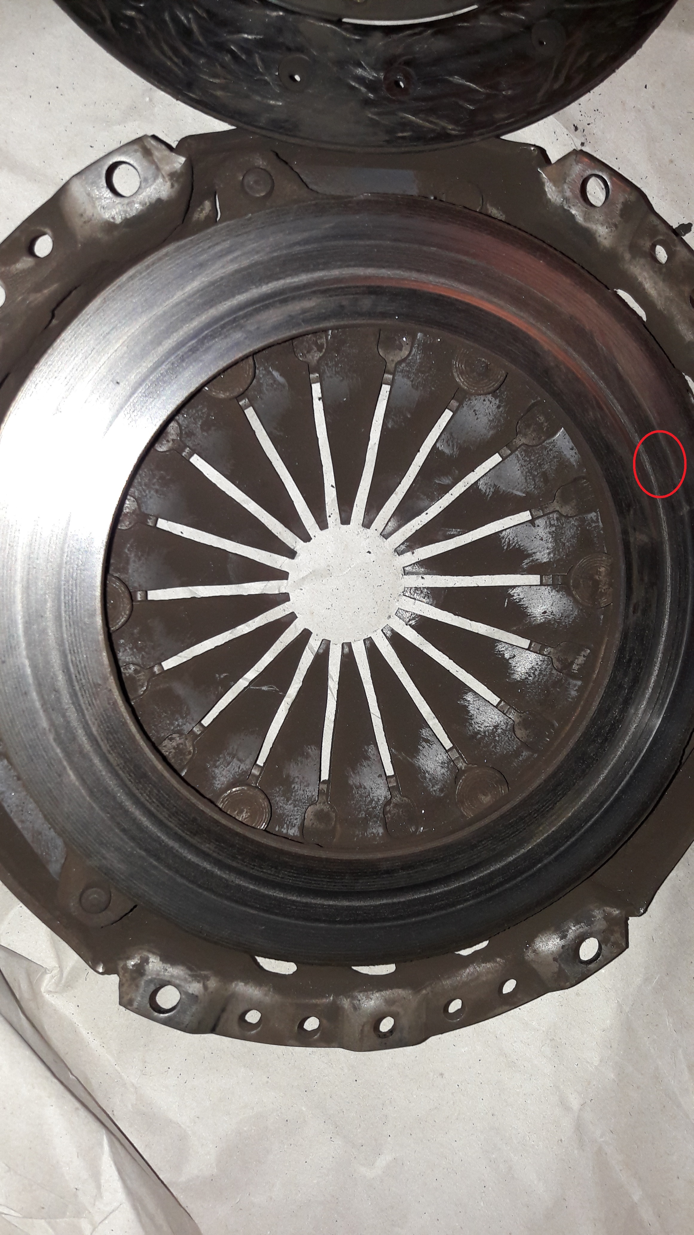

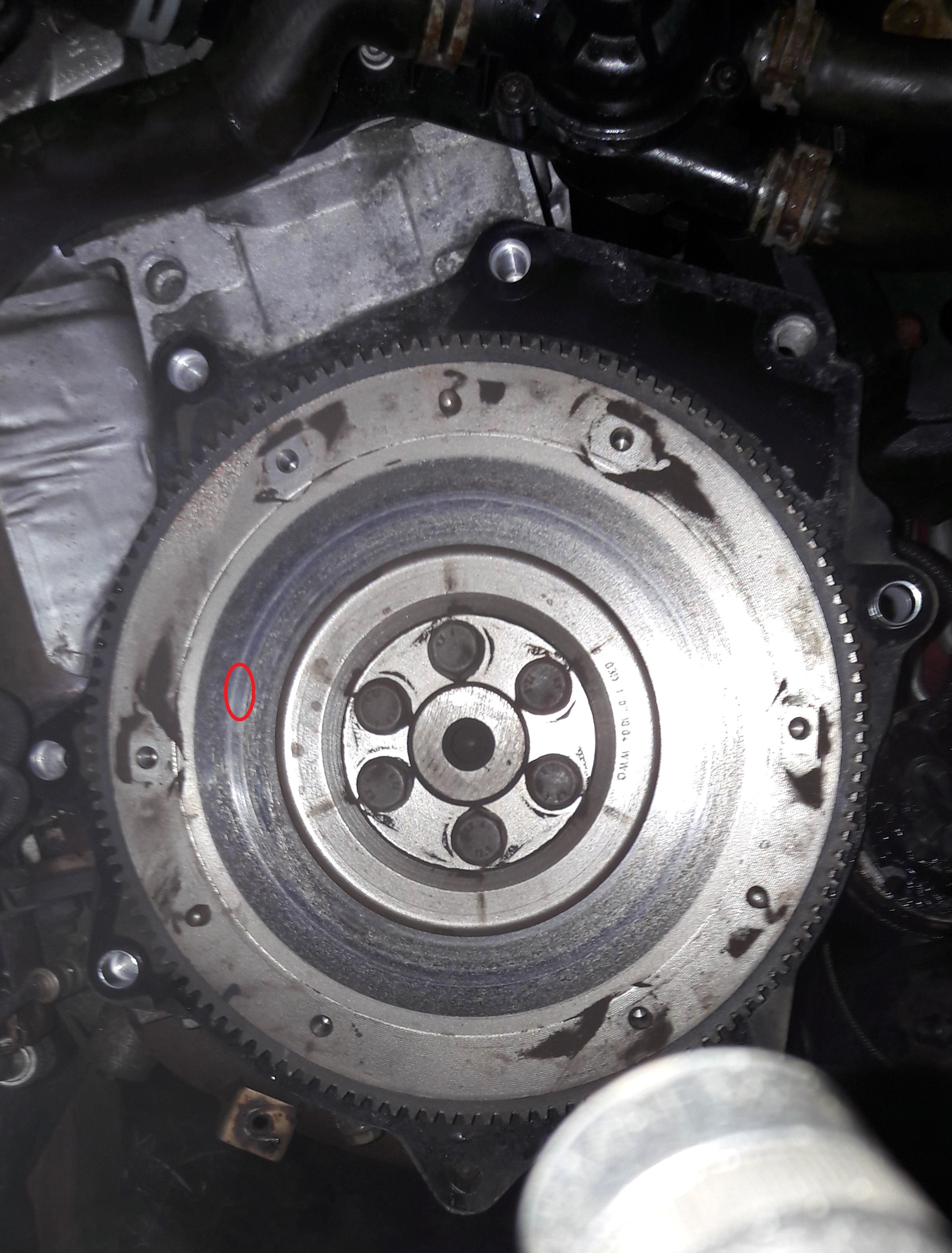

Old friction disc was down to rivets on both sides, marked the flywheel but not to any fingernail-detectable extent; quite a groove on the pressure plate though:
Will inspect the clutch lever later on, and pop up some pics for opinions on replacement vs reusing.

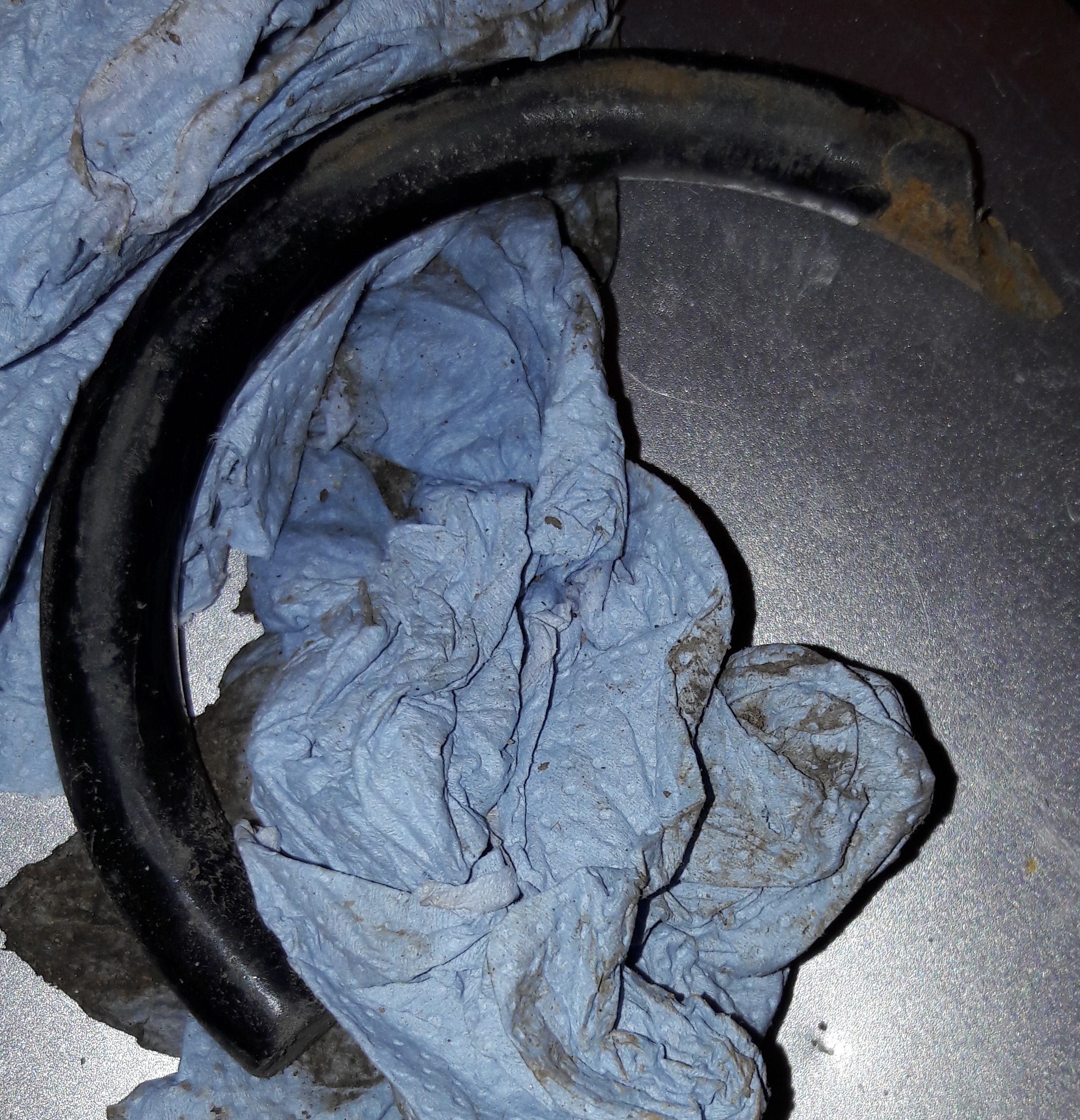

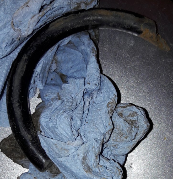

Haven't got the energy to waffle on any more just now.  We were supposed to be out this afternoon visiting friends but within 300 metres of departing in the Polo, a really offensive knocking noise started coming from the front right corner. So we turned round and found this after an exploratory jacking:

Well done with the clutch job, Pete. I guess you must have reused the original release arm?
Bad luck with the Polo spring. Looks like that spring had been broken for quite some time judging by the rust at the break point.

I think the Polo will remain driveable with that bit missing, and if it does carve up the bottom spring seat a bit, who cares, the whole strut will be getting changed out along with the spring, topmount, bearing etc. When I regain some enthusiasm for outdoor, mid-winter carfixing. :sweat:
