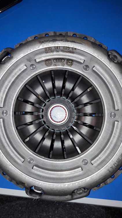

  • Alignment tool knocked up this lunchtime by a friend with a lathe.  Measured what the larger diameter needed to be off the friction disc, then scaled off a google photo of the genuine tool to get the

It occurred to me sometime late last night that with new friction disc and pressure plate already on hand, I already have everything needed to make a tool?
Make tool that puts red circle slap bang in the middle of blue circle, yeah?
Edited by Wino
yes you can get one that expands out on the pressure plate side to center it, or a decent bit of nylon and 10 mins with a lathe and your sorted, don't forget the large hole will get smaller as the pressure plate is tightned up tho lol so you need to measure it with the fingers pushed level somehow, if I remember tomorrow I'll measure the hole in the crank spigot as if your making something it will be easier to line it all up that way.
  • Sponsor
Ah, thanks, I'm starting to understand now.  I didn't think the pictures of the official centring tool could quite look like what I was thinking of making per post #16, so I had a feeling I was misunderstanding something. So it's really crank-to-friction disc centring that I want to be doing, once that's right, friction disc to pressure plate has to be right.
Measurement of the crank spigot would be awesome if it's not too much trouble, but I guess once I have ours in bits I can do that myself. Being able to make the tool ahead of time would be nice though. :)
