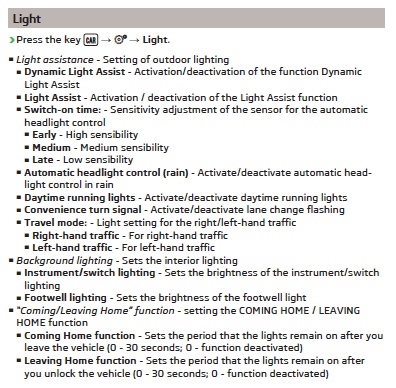

I may be missing something here but I have an October 2015 SEL Exec with day time running lights, but within the Columbus Lights Menu I cannot find the option to turn them off, I have Light Assist and Blind Spot Detection, TSR etc.
Any ideas on this.
There's no option to turn them off, this can be added with VCDS though.
Thanks Gizmo68, as always this forum always comes up with the answers, odd that the Daytime Running Lights option is shown in the Columbus manual though.

Not sure why it is shown in the manual if you do not physically have to option in the Columbus, car manuals who need s them :)

I only asked because i found it within the Columbus Manual, it showed it as an option, but when i checked on my Columbus the option was note in the menu.
