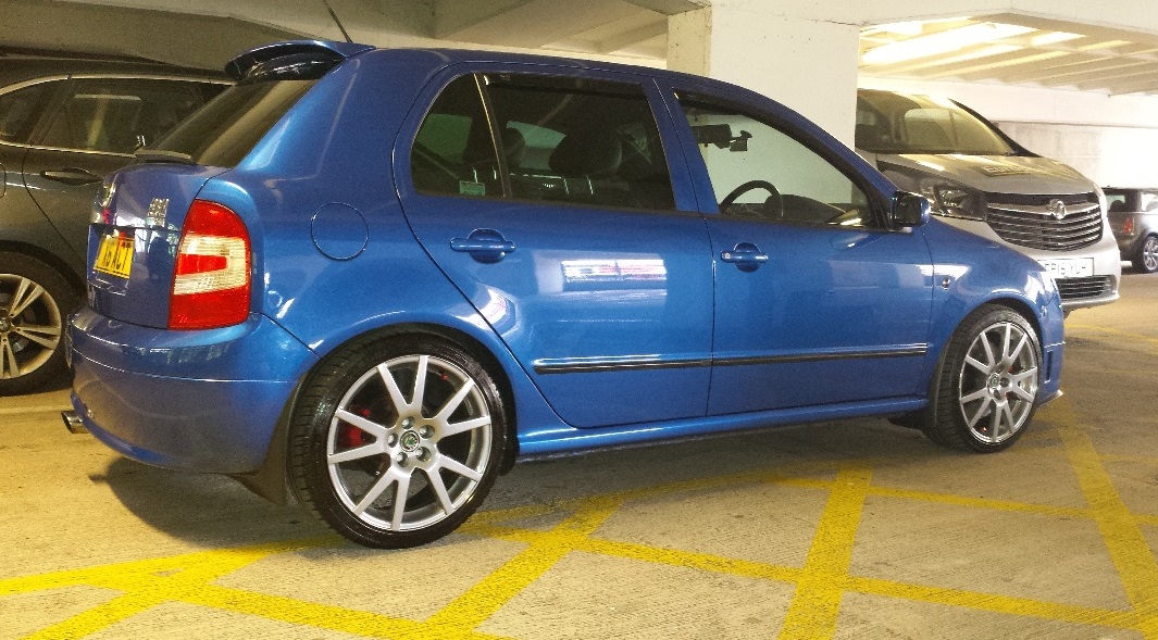

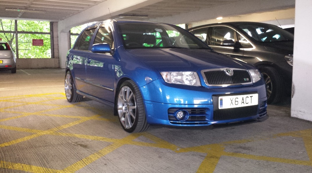

'TUFTYTHESQUIRREL' your VRS looks great and is about the right height I am aiming for when lowering mine. Would you kindly confirm the height of the springs fitted to your VRS?
- Just to give me an idea of the drop? I don't want to go too low. (Bloody speed bumps)  Cheers.
Hi,
This was the delivery note:
Item Name: AP 25mm Lowering Springs & Shocks Suspension Kit
Item Part Number: SP82-018
I've never grounded it on the road, only ever scraped the front splitter/spoiler once, but that was leaving a house coming onto a heavily cambered side street.
Oh, fitting - I gave the local mechanic a hand do it. On the front, don't take the bottom arm off, just disconnect it from the strut and gently lever it out of the way with a long bar. If you have a car lift (or can rent one), it took us just under 2 hours. That included a cup of tea and a chat. That is, only pay 2 hours labour for fitting. Indy garages in our are £40-50/hour.
