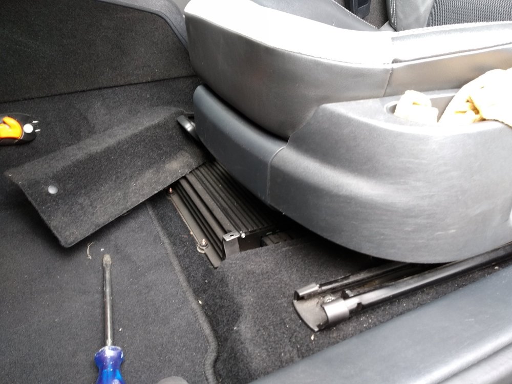

If you don't have the DSP Sound System it is, but if you have the DSP System (in my car the DSP external amplifer is located under the driver seat) you will need a radio unit able to activate the DSP through the Can-Bus or you have to do the steps explained in the first post.

A bit of a thread dredge.  But I'm having the same issue.
Octavia 2 Scout with Audience Headunit and the factory amp under the passengers seat.  Installed an aftermarket android HU and everything works except sound.
I have volts AC on speaker outputs.  I have canbus control working for everything else (steering wheel buttons, steering angle etc).
But I have no sound through the speakers.
Disconnecting the battery didn't help.  I've done that overnight.  Reconnecting the stock HU works fine.
Does anyone have a work-around, known working canbus adapter or other method that doesn't involve splicing 2 dozen wires?
