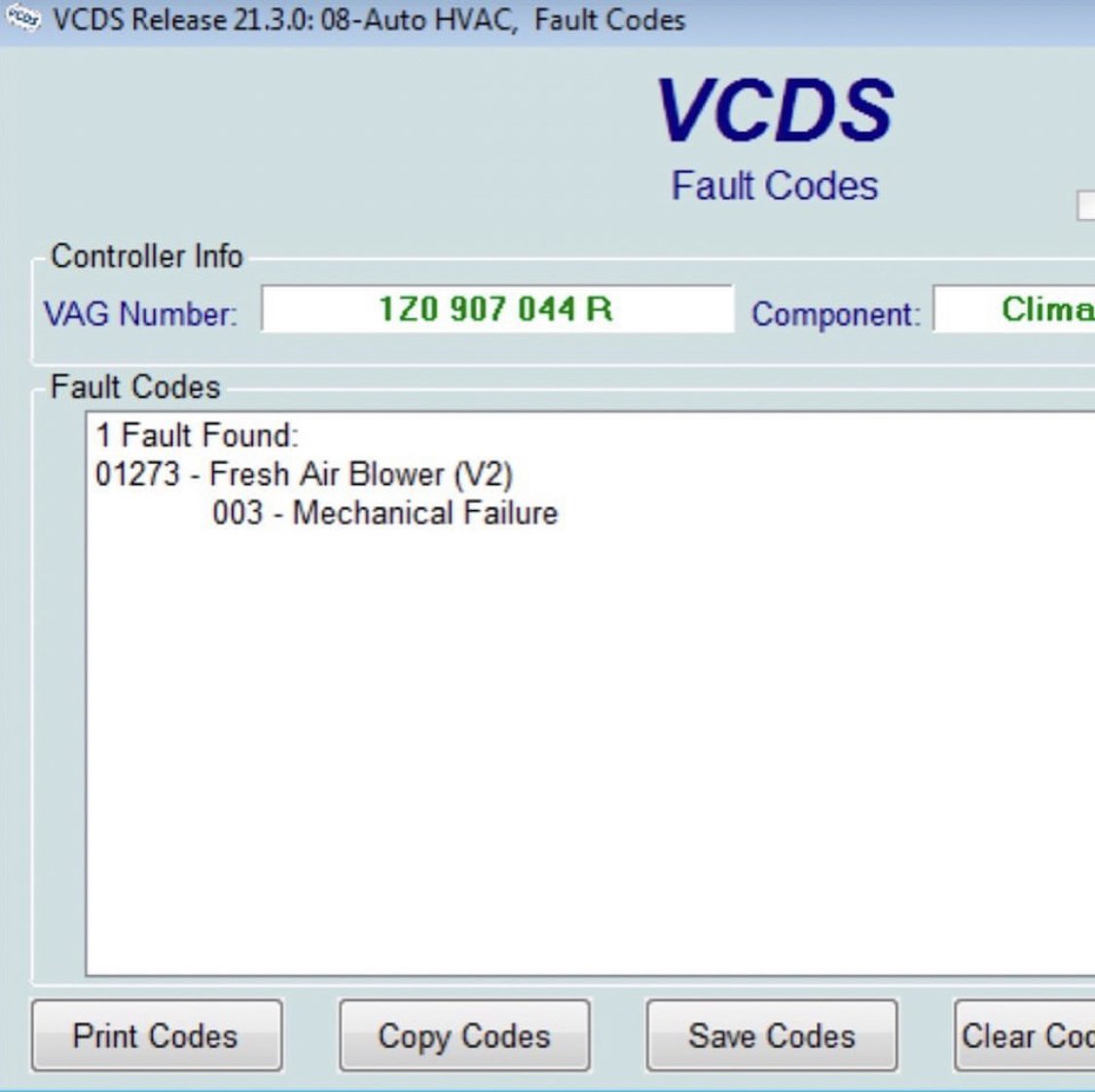

  13. When you say the Air Con is not working, do you mean the air conditioning or the fan? They’re two separate things and the fan/heater can operate without the air conditioning (cooling/drying) functioning In my experience, fault 01273 was a failed fan (also called blower motor). They are quite common to fail. But check your fuses first, and also try the fan on all fan speeds. If it works on max speed but none other, likely just the blower motor resistor that has failed. If it seems like blower motor itself has failed, take out the cabin filter & the fan for a visual inspection. They are easy to access in the passenger footwell. On our cars, the blower motor comes first and then the filter is after the blower. Unfortunately this design means debris from outside could get sucked in and damage or clog the fan before reaching the filter. If your car sat for a long time, it’s possible a rodent or something got in there and made a nest. So do a visual inspection / clean out before ordering parts
