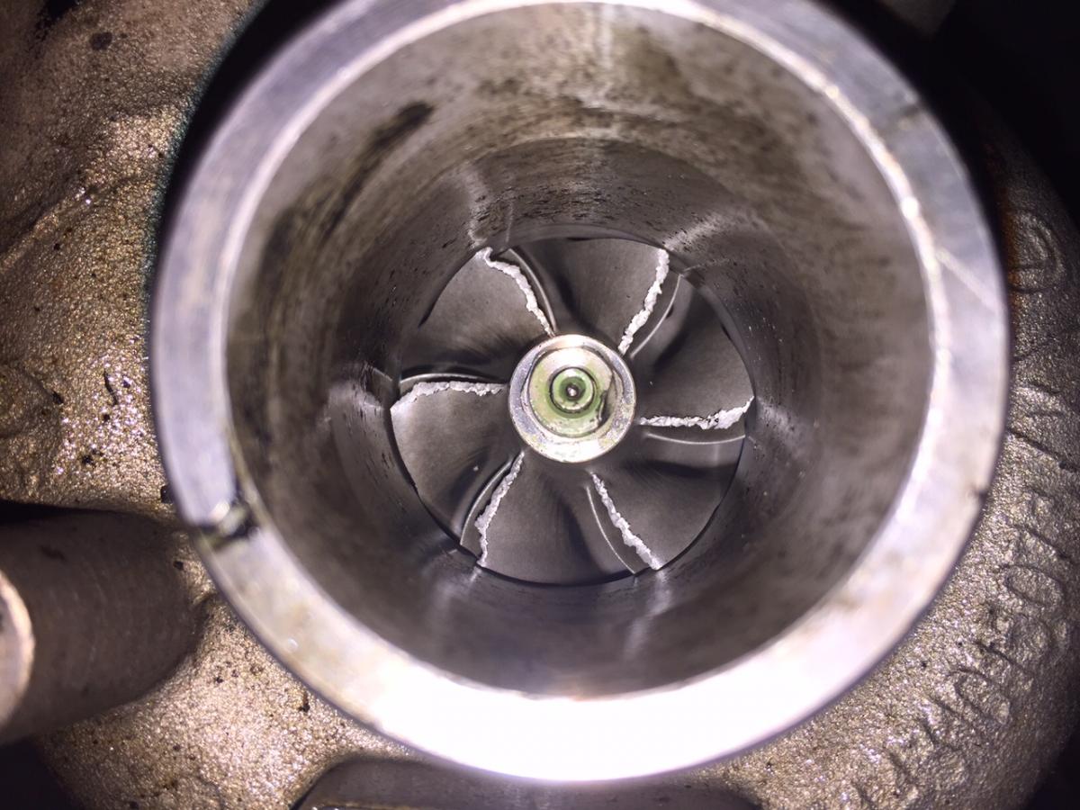

ive attached a picture of the turbo impeller on the cold side of turbo, she aint pretty,
only symptoms of this was like a secondry noise like an exhaust leak, till we stripped egr cooler intake manifold ect looking for a blow, when there was the none only culprit left was the turbo
so my motor is up on stands now with half its guts out lol, till I can source a turbo

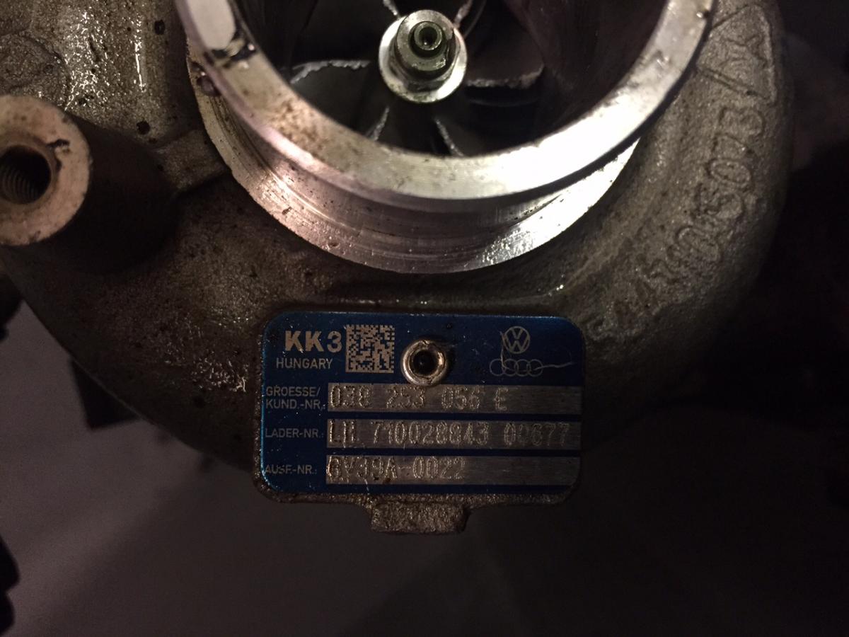

What's the part number on the turbo?
Have you been able to resolve the cause - was there an intake leak or split air filter?
a picture speaks a thousand words
hope this what ya after lol
What about this ebay listing for some details for you to search around on even if you didn't use this supplier? Lists alternative vehicles and part number which you could match up. Not knowing the going rate for a 1.9 tdi turbo seems cheap though compared to prices I'm used to....
http://www.ebay.co.uk/itm/Turbocharger-1-9-TDi-BJB-BKC-BXE-BXF-BRU-BXJ-AVQ-751851-kp39-011-kp39-022-/360941854847?_trksid=p2141725.m3641.l6368
Edit: Yes, that part seems to marry up with the photo of the part plate on yours.

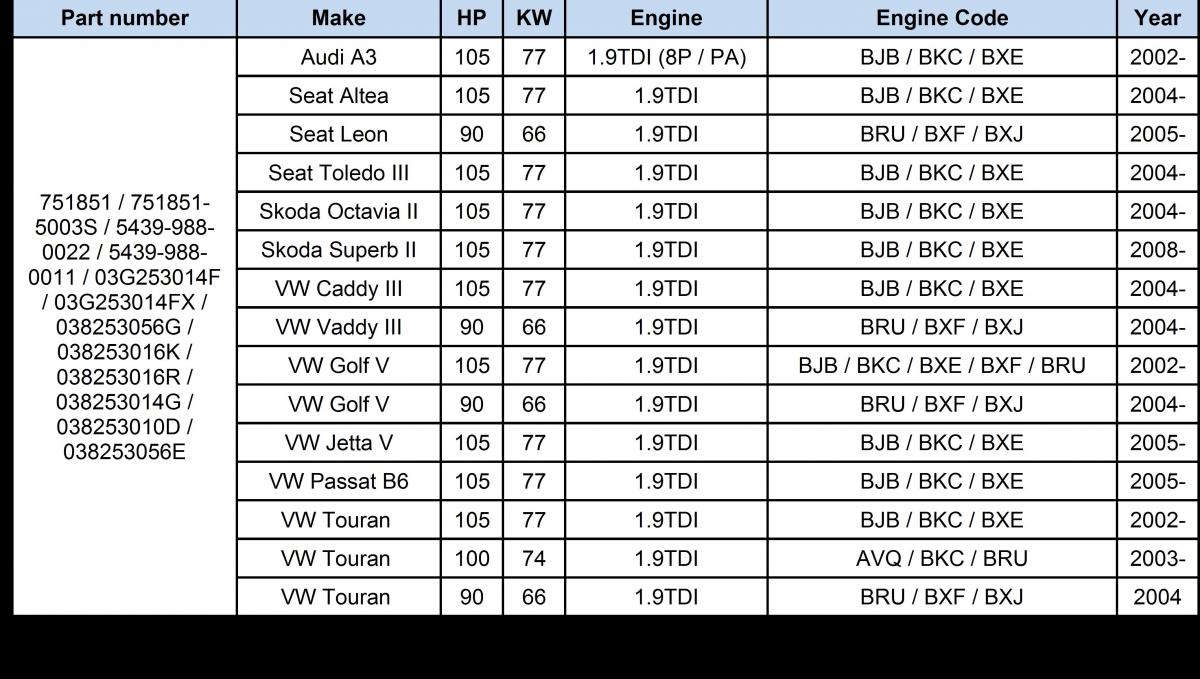

£200 seems about the going rate for remanufactured
http://www.londonturbos.co.uk/BV3954399880022.html
Would you bother with 2nd hand wreckers with that sort of cost? More hassle than worth?
A nice summary table on other compatible vehicles too.
