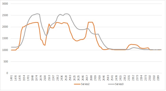

I have been searching the forums with my problems and tried most remedies and now a bit stuck. Pretty much the car was all fine, and I accidently knocked off couple of vaccum pipes, but re-connected them straight away. Anyway I started to get underboost problems, so i replaced a couple of the vaccum pipes which stopped that, but but now I get over boost.
The problem I cannot understand... The car drives perfect and is really quick ( Remapped 2 years ago) but as soon as you cruise at about 70MPH you get limp mode, over boost code. I can drive it hard in 2nd etc and it is fine. Guaranteed limp mode every time.
Here is the code
17965 - Charge Pressure Control
            P1557 - 35-00 - Positive Deviation
I am at the point now, where I can only think to try the Mr Muscle, but this i am not 100% will fix it as the car drives perfect in low gears, even if you drive it really hard.
I have attached graph from vagcom of actual boost v  delivered boost. Hope someone can make more sense of it than i can, as when i logged the data it does not tell me which is actual boost and which is delivered boost!!.

I tested the vac pump with vagcom and it seems to be doing its job all ok. I have now cleaned it out with Mr Muscle, only taken for a small drive and all seems ok :)
Hopefully it has sorted the problem.
