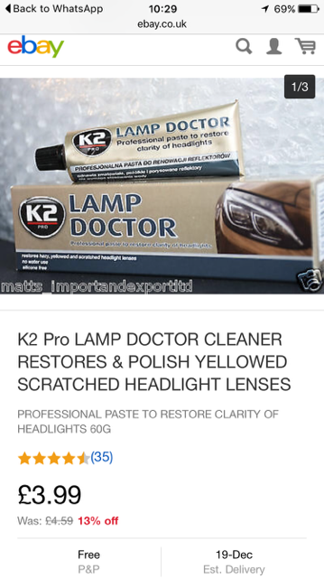

Hey peeps, has anyone tried this stuff. Seems to be good value for money.
It would probably be OK on lightly damaged ones, but I adopt a more professional approach.  Wet and dry 1200 - 2500 (building up grades) using an eraser as a small block for even pressure, compound by machine on a 2" wool pad, polish with lighter polish on a 4" foam pad.  Seal with anti-UV sealant. :)  Done quite a lot of sets of lights down my way in Devon.
