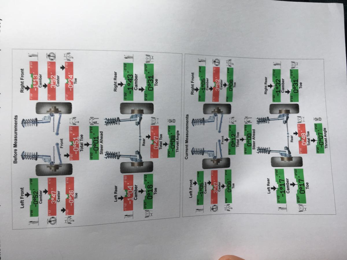

I very much doubt it will be the springs mate. I've put h&r on mine and had it hunter aligned at......... kwik fit of all places. They did a great job tbf but I do know the guys there, they do a lot of track day stuff on the qt...mine was pulling to the left before springs and then slightly better affter I fitted but alignment was most defo out... Mine is on the standard conti 2's and I can't wait To wear them out so I can put something decent on.
This is the before and after on the hunter

Do your fronts seem to have a fair bit of camber after fitting the H&R springs?
Edited by S27VEJ
Don't seem to. There is more than before tbh but it sits so bloody high on standard vrs springs I'm not surprised. There will always be some more camber when lowering because it pulls up the bottom arms in their natural arc slightly. Tyres are wearing ok on front tho and there's nothing wrong with a bit of neg camber ;-)
Looking at the alignment they seem to have neg 1 degree. That's not a lot really but it is nice to have some
