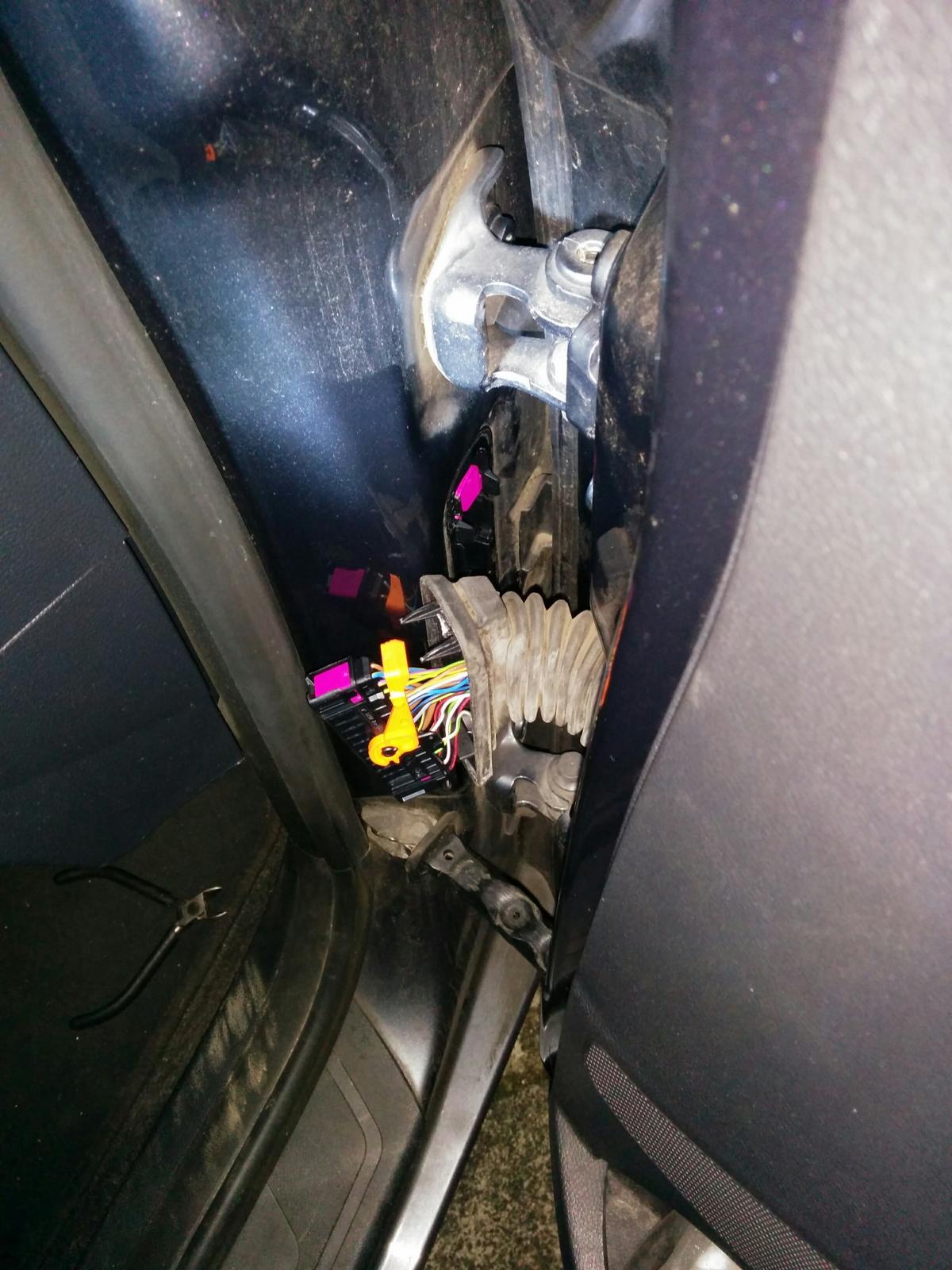

It is certainly worth a look in the very common area where the wiring loom breaks. Between the car and the door, where the door hinges are, the wiring is in the black concertina gaiter. Push down gently in the middle top of the gaiter where it attaches to the car body. As you push down pull the gaiter away from the car, the gaiter will come away from the car body at the top. Once free at the top the rest just comes away from the car body side. Push the gaiter back towards the door as best you can and look inside for any broken wires.

It does not unclip from the door. It only unclips from the A Piller. You push down in the middle at the top of the gaiter. Push down on the black rubber directly where it joins the A Piller. There is a clip that hooks under the metal of the A Piller hole. Push the clip down and the gaiter will come away at the top.
As you see in the photo I broke my plastic clip. But I then changed the whole loom anyway, so all was replaced.
However I have checked other doors. Try slipping a thin flat screwdriver between A Piller and Gaiter. As said top of gaiter in the middle. Push down gently and lift gaiter away.

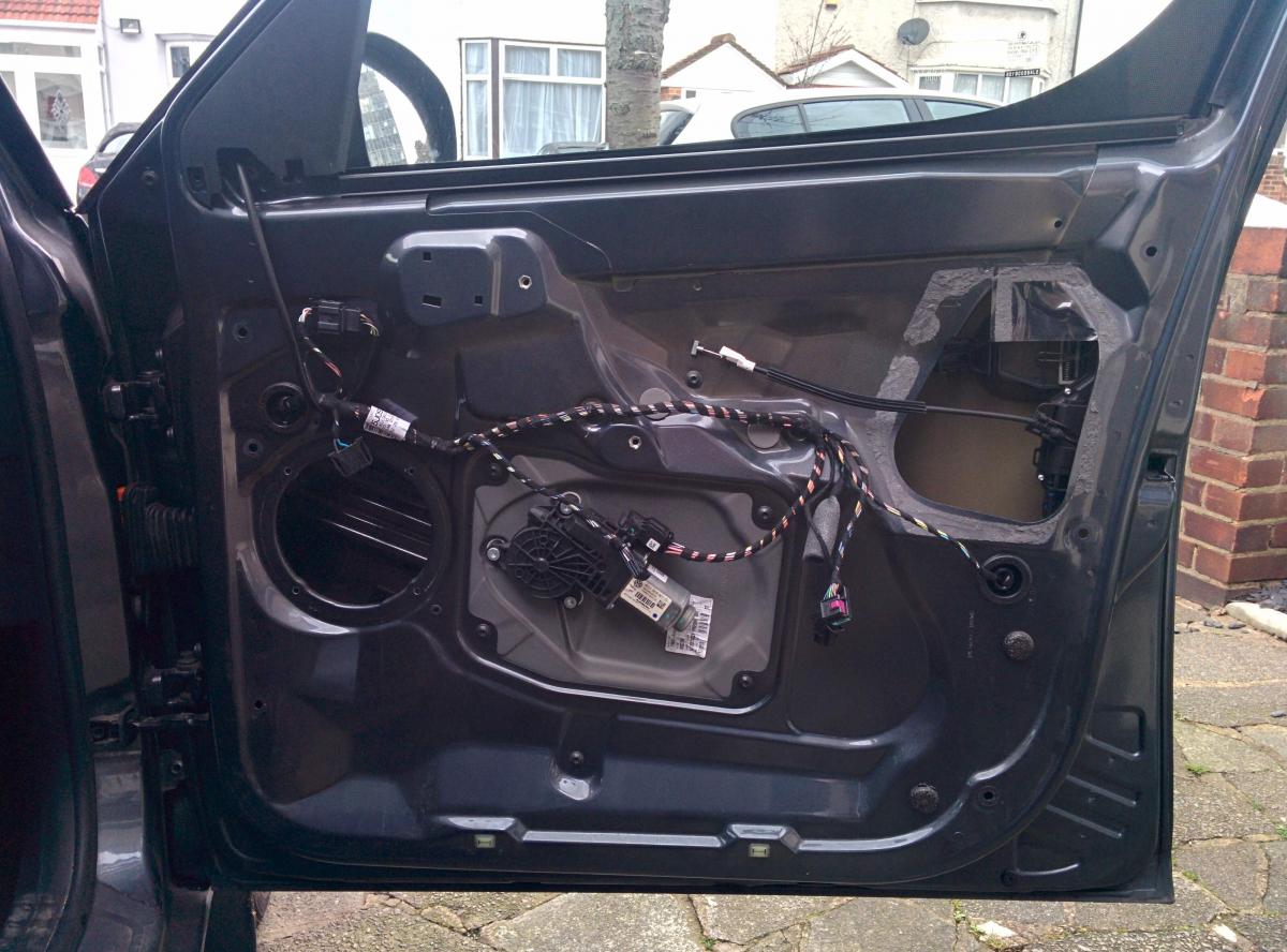

The whole door loom was about £90. To replace that you need to remove door handle, then door card, drill off 4 speaker rivets and carefully pull off a piece of thin foam allowing access to the door lock connection.
Then threading the new loom is quite simple, I glued the foam panel back.
Buy new door card clips and 4 new speaker rivets. Also get the exact part number of the door loom from the label on the loom in the door. There are few different variants and you want to order the correct one.

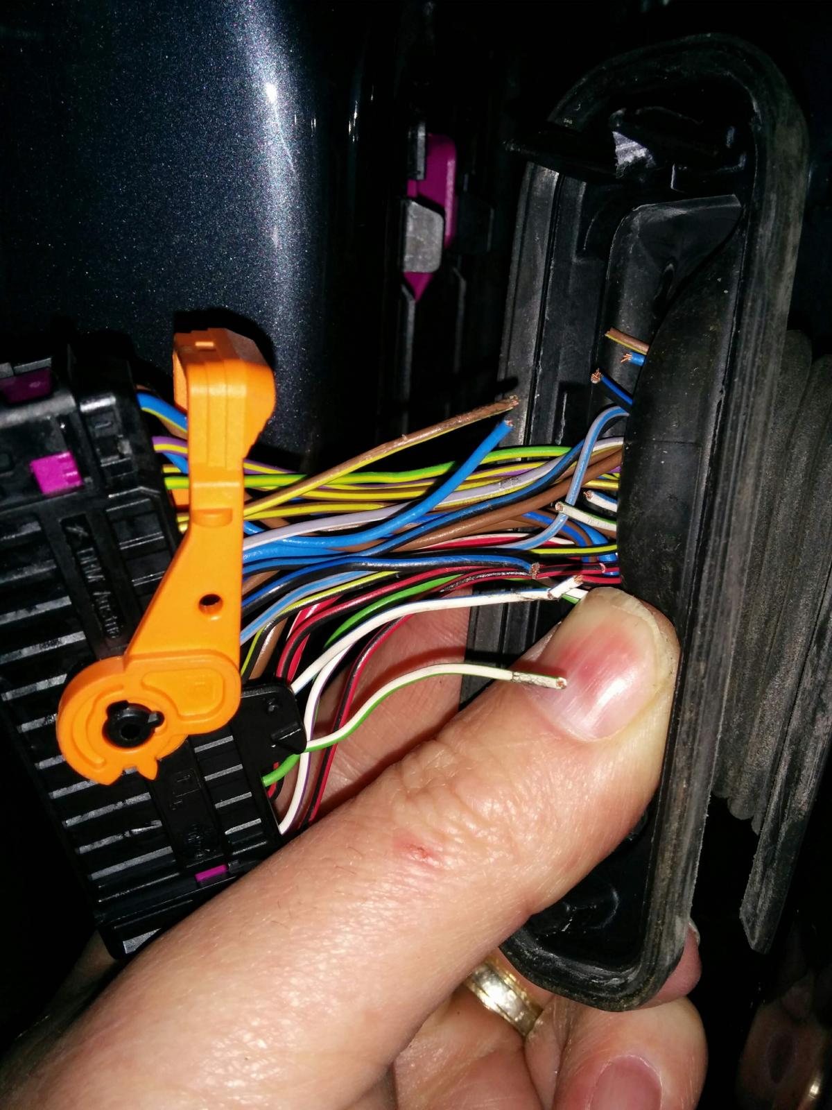

Well after about a year, i made the descision. I grabed an old cloth and a flat screwdriver and with a bit of agony i managed to unclip the gaiter.
And... Tadah... two wires cut and one more ready to.
A bit of cutting, extending , soldering and covering tightly with duct tape and finally i got back my remote door locking and unlocking.
