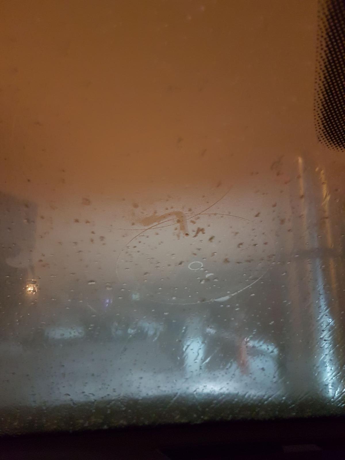

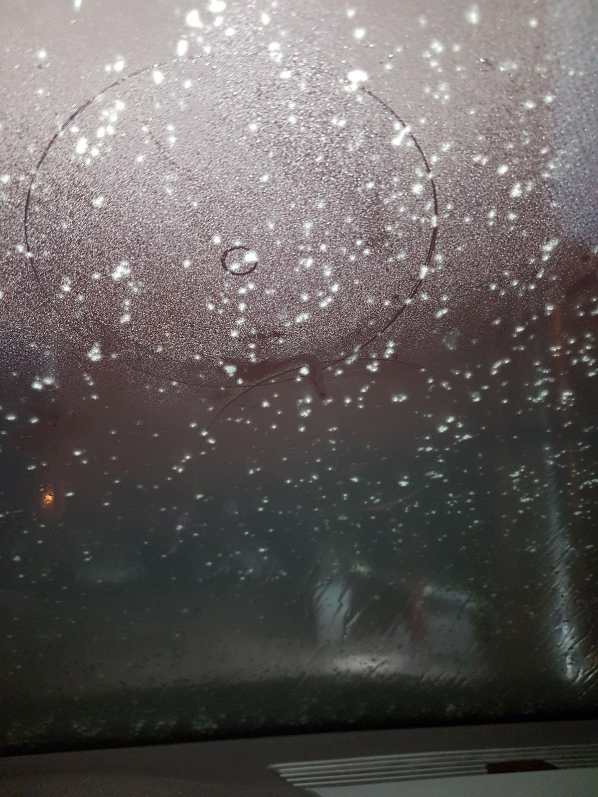

Seems condensation brought up two weird circles on the interior of my windshield. Cleaning up the surface doesn't seem to help, is the windshield damaged or what's going on? Mind you, this is brand new car ...
Here some pics:

Believe it is the factory equipment that lifts the screen into place that leaves those marks

It has nothing to do with poor quality. It´s from the factory when the windscreen was fitted. Watch the "production of Skoda Superb" video on Youtube, and you´ll see.
Aren't these just suction cup marks, requiring some rubbing with IPA or similar de-greaser to go away?!
suction marks from the machinery when fitted.
Just needs a proper clean.

Try alcohol/meths

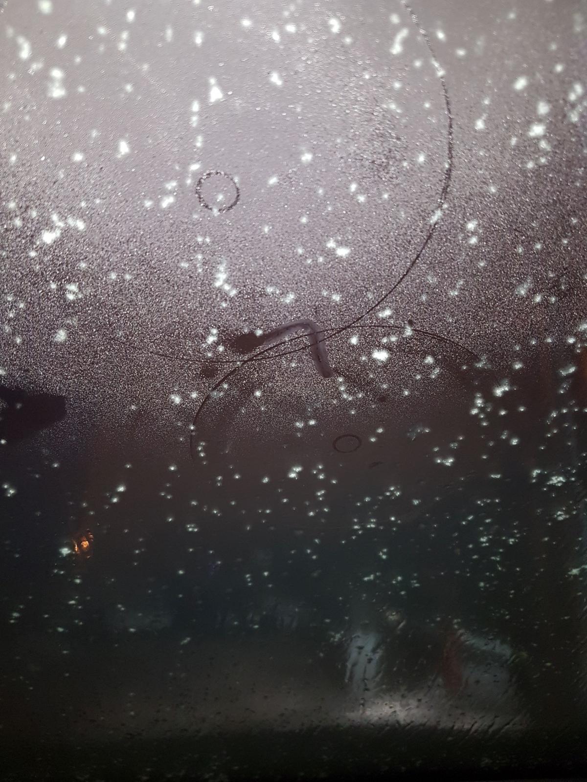

What about this on my Octavia 230, visible when the screen mists up

I haven't specifically tried to get rid of them, but all the cleaning of the windscreen hasn't got rid of them. They only show up under light condensation, so aren't a problem.

You can clean them off with a damp cloth and a knob of tooth paste the fine abrasive in the tooth paste will not damage your windscreen it will clean the sucker marks off
