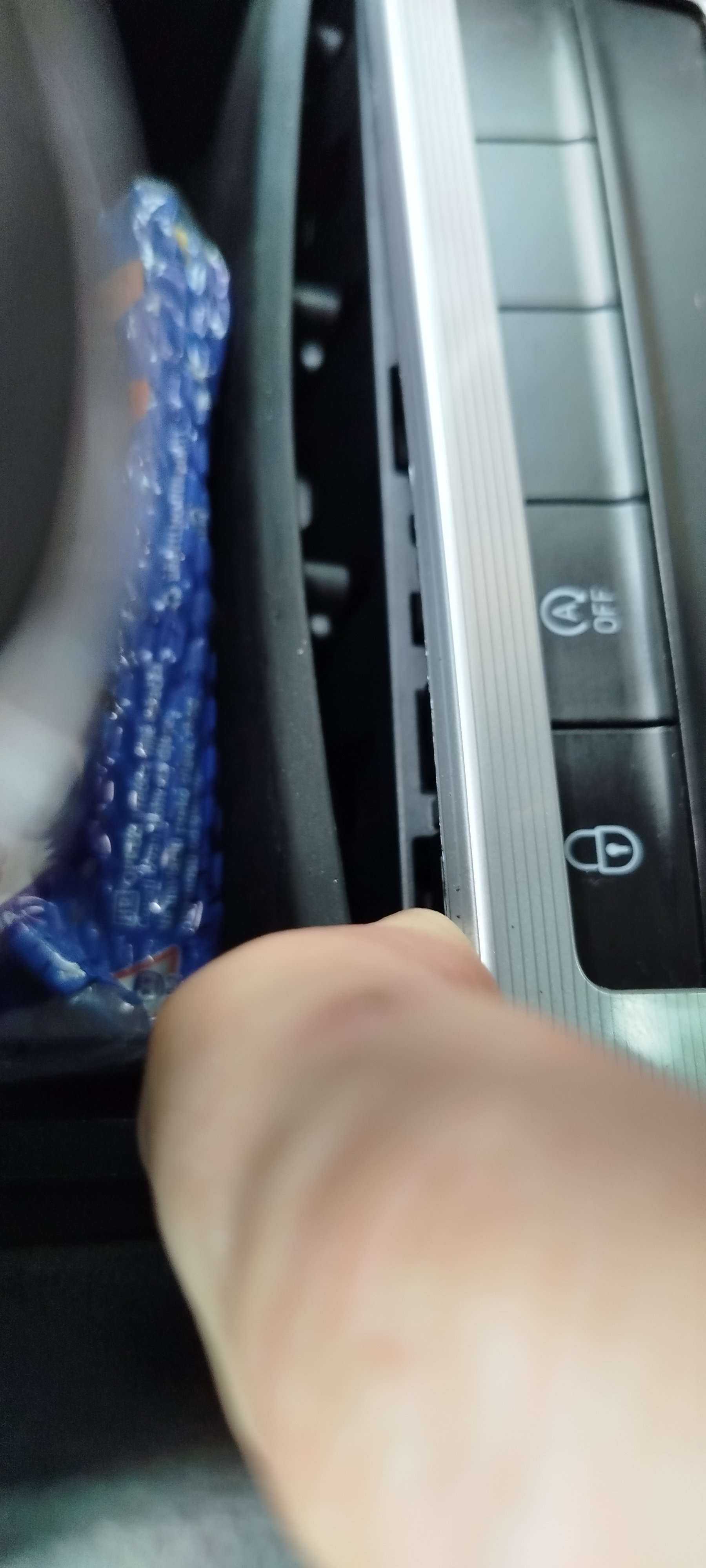

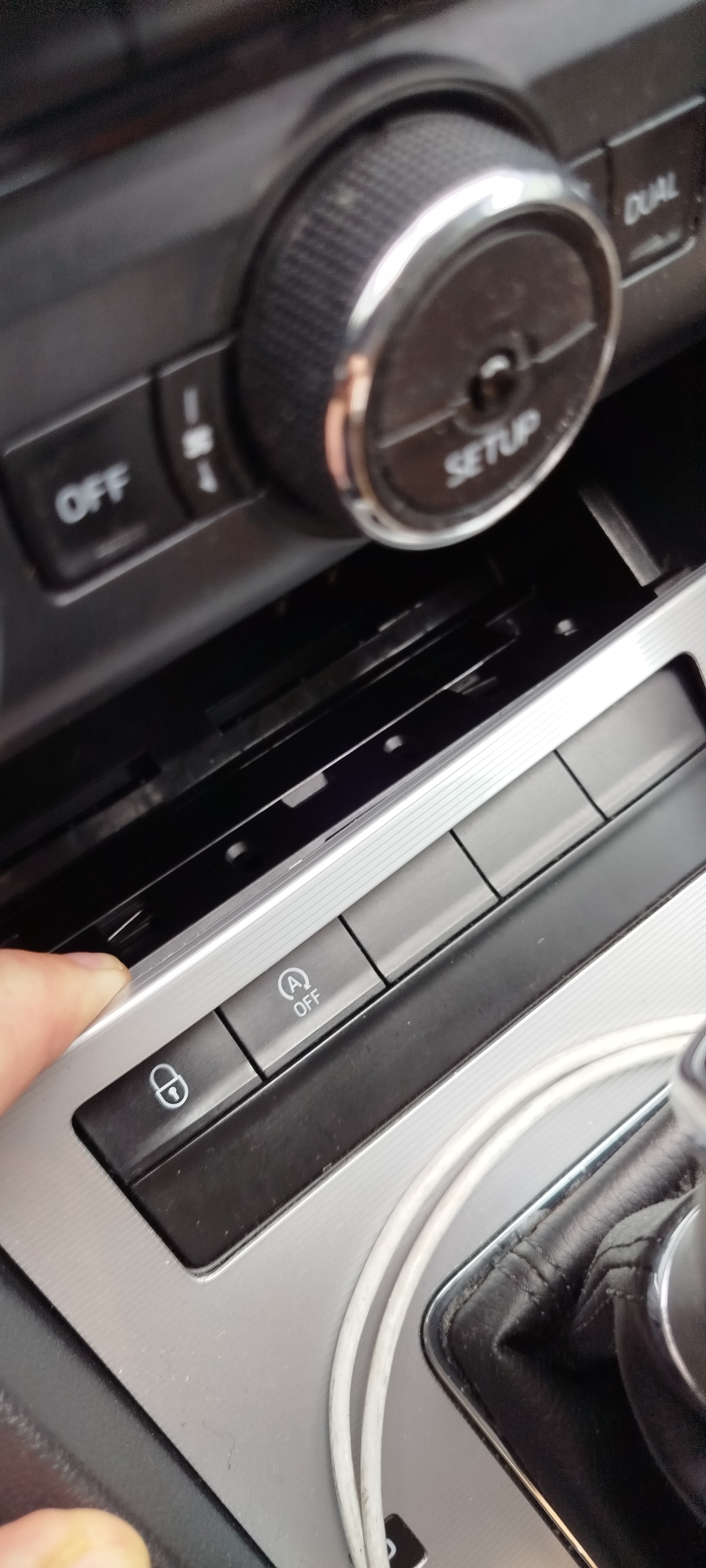

Just use a pair of flat bladed panel tools, insert it at the rear of the gearshift cover and pull the cover up.
Disconnect the three electric connectors from the underside of the cover

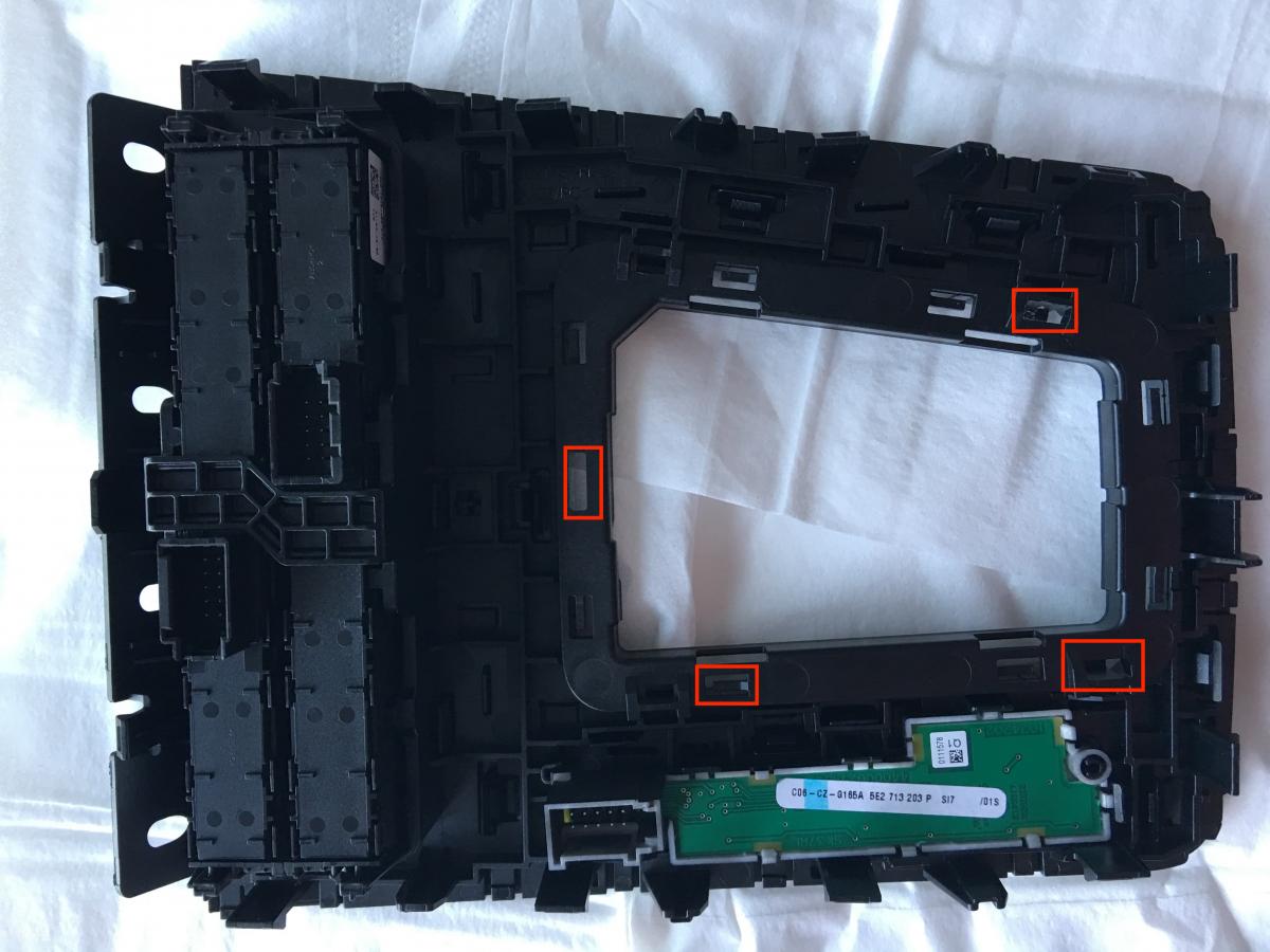

From underside; use a screw driver to press onto the clips that holds the protective cover around the gear lever and separate the protective cover from the gearshift cover.
Thanks! Managed to get it out, was a bit tricky to get the silver surround out (which holds the leather gear stick protector). Once I managed to figure out which clips I needed to push up with the screwdriver all went OK.
In case it helps someone else, here are the clips you need to push up with the screwdriver to remove the surround. Once it's out, rotate it sideways to get the centre console overlay out without removing the gear stick.
