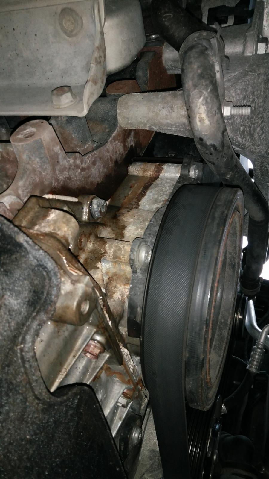

After I put the Yeti up on the ramp, it was clear there was a lot of fluid sitting on the engine's underside cover.
The lining on the sump was saturated with coolant.
The coolant is dripping down the slide of the engine block behind, what I think is the timing belt.
I could see roughly where it was coming from but not source, this is a pretty decent photo.
So it doesn't appear to be a loose pipe or radiator, could anyone throw more light on the problem for me.

Sounds like the water pump.
If you have a timing belt it would be a good time to renew also perhaps
I had a water pomp bearing go completely years ago and it threw the cam belt off.
If the bearing is wobbly enough to have caused the seal to leak it could wreck the engine in seconds.
Seconded. It not only sounds like the pump seal, but photo 2 looks like a blown pump seal.
Mine did the same thing at about 80000klms. New water pump fixed it....deciding to do the timing belt as well pushed the repair bill up a little more.
