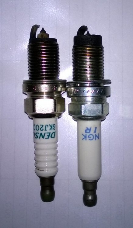

The borescope has been done and they have said there is no damage as far as they can tell. They have put new plugs in and have had the car running with no issues but they don't want to let me have the car back until they have an answer from Skoda. They have said they want me to do the oil consumption test which I have to pay for and if it fails then Skoda uk will supply the parts and I have to pay for labour. What I don't want to do is have to pay for extra parts and labour if due to the fitting of incorrect spark plugs has caused these current issues or any possible future problems with piston/plug number 2.
Do not pay anything really.
They put in the wrong  plugs at the last service, and now under the OEM parts warranty they are replaced.
Do your own oil consumption test because you said it never used oil, the Master Tech said it did.
It was the wrong plugs, one fowled and burnt the tip.
Sorted, and if they have the latest software on now if they never did at the last plug change things should be good.
Run 5w 40 FS Oil, VW502 00 and do not let the Dealership or Skoda rip you off.
If it is burning / using oil in the next 4 tanks of fuel then let them do the Official Test and you will not have to pay if it is an oil user.

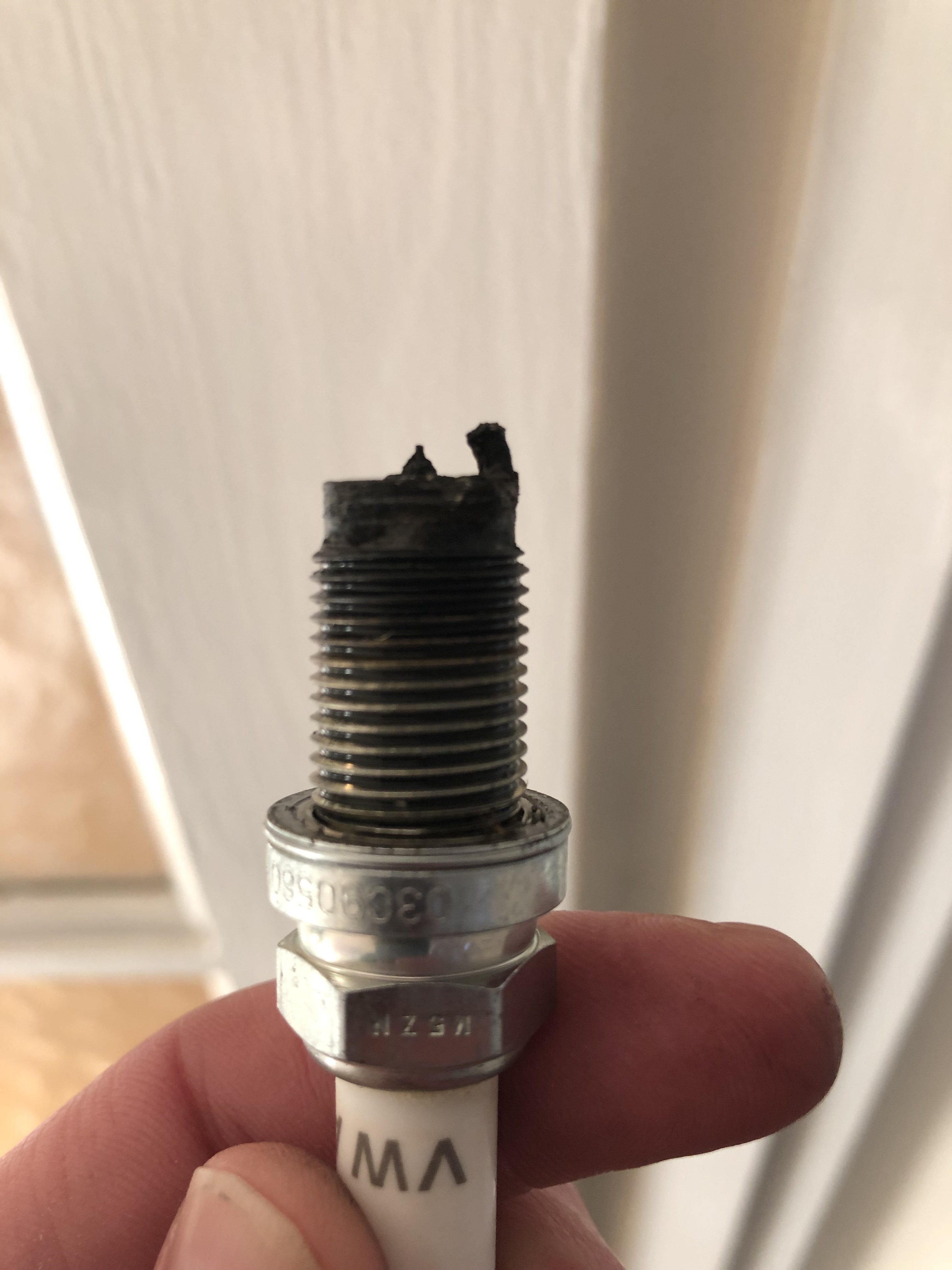

I wonder if anyone could help me, my 1.4tsi engine with a cthe engine in has failed because apparently my spark plug had broken off and fallen into the engine. The car was taken to the dealership two weeks previous to it breaking down as It wasnt driving right, after they had changed the water pump. They had the car for two days and said that the car is perfectly fine and there’s nothing wrong with it. It then broke down on me and this is the situation I’m in now.
Any help would be appreciated
Welcome.
If there was no tip to retrieve and no scored bores then it never broke off it was burned down.
Not uncommon if you look at the Spark Plug CAVE / CTHE thread pinned above.
When the tip does break off as it has for a good few you know about it.
So who’s at fault for this since they had the car two weeks ago and clearly didn’t diagnose the fault. The repair bill has come to 6 and a half grand
You never told the full story.
Sorry, i misunderstood, i thought the car was OK now.  Just a plug with a tip no longer there.
 A replacement engine installed in the UK is not £6,500 as much as main dealers like to say they are.
Are you saying it is wrecked and the broken tip is there in the cylinder?  Is the diagnosis, Bore Scored, Piston or valve burned out, ring / scraper broken or what?
What was the Fault Code they acted on, 'Misfires'?
 If the Water Pump was needed surely the spark plugs should have been checked / replaced as well.
What country are you in?
Was this a Main Dealership that replaced the Water Pump?
What servicing has it had and when is there a record of spark plugs being changed?
http://briskoda.net/forums/topic/475841-2012fabia-combi-rs-cave-engine-is-toast
I only know from what I was told on the phone yesterday, a brief conversation. But yeah they said the tip has come off and gone into the engine and burnt it out or some **** like that. The water pump was done through main dealer. I am in the UK, West Midlands. The spark plugs had been changed by a independent mechanic a year ago so I know they were definitely changed. I am most certain that it threw misfire codes up. I maintained the car, always topped up oil with recommended oil. When they had replaced the waterpump when I got it back it was throwing up magnetic clutch supercharger sensor fault and that was when I took it back and they said everything was okay which clearly it wasn’t
