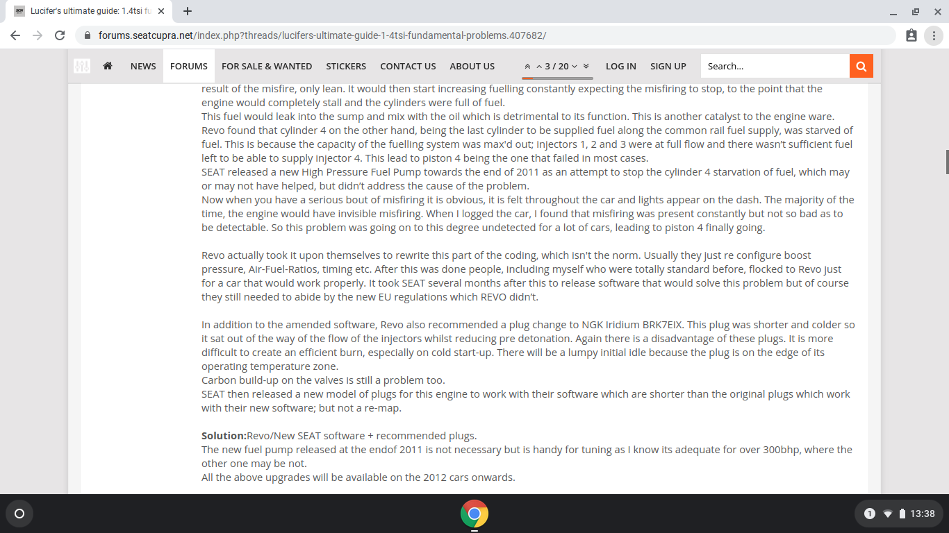

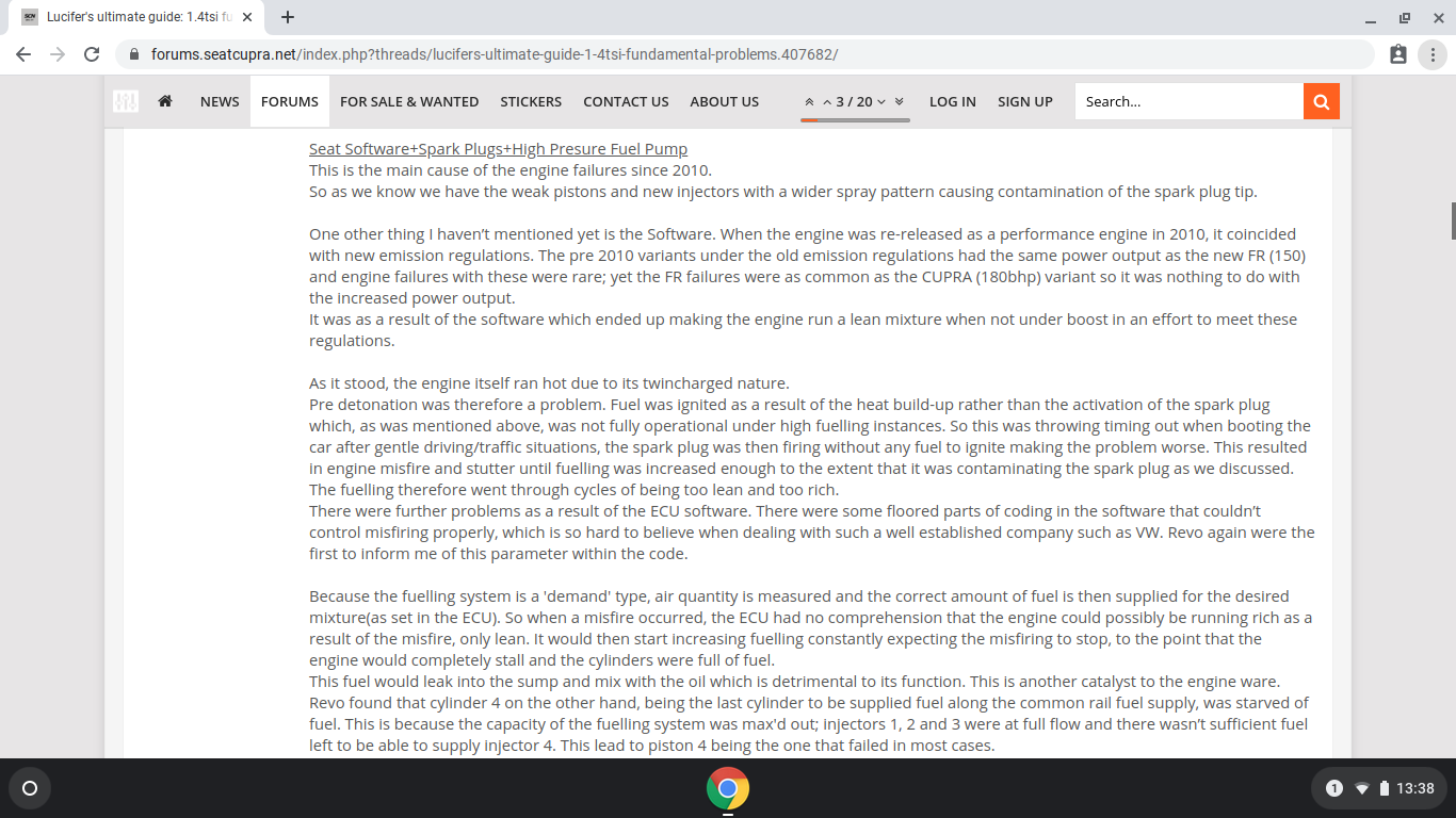

@Uzayr - Well, with the additional information from @Roottootemblowinootsoot (thanks mate) I'm thinking that a peculiarity of the 1.4TSi cylinder head design, combined with the NGK plug design can lead to the plugs overheating. The (clearly not adequately documented) workaround would have been to fit Denso plugs in these engines.
I don't think the NGKs are rubbish plugs, but they are a potential killer of this engine. Upthread you clearly show that you ask for a specific job to be done, and it was done. The fact that you did not ask for a different job to be done as well is not the garage's fault!

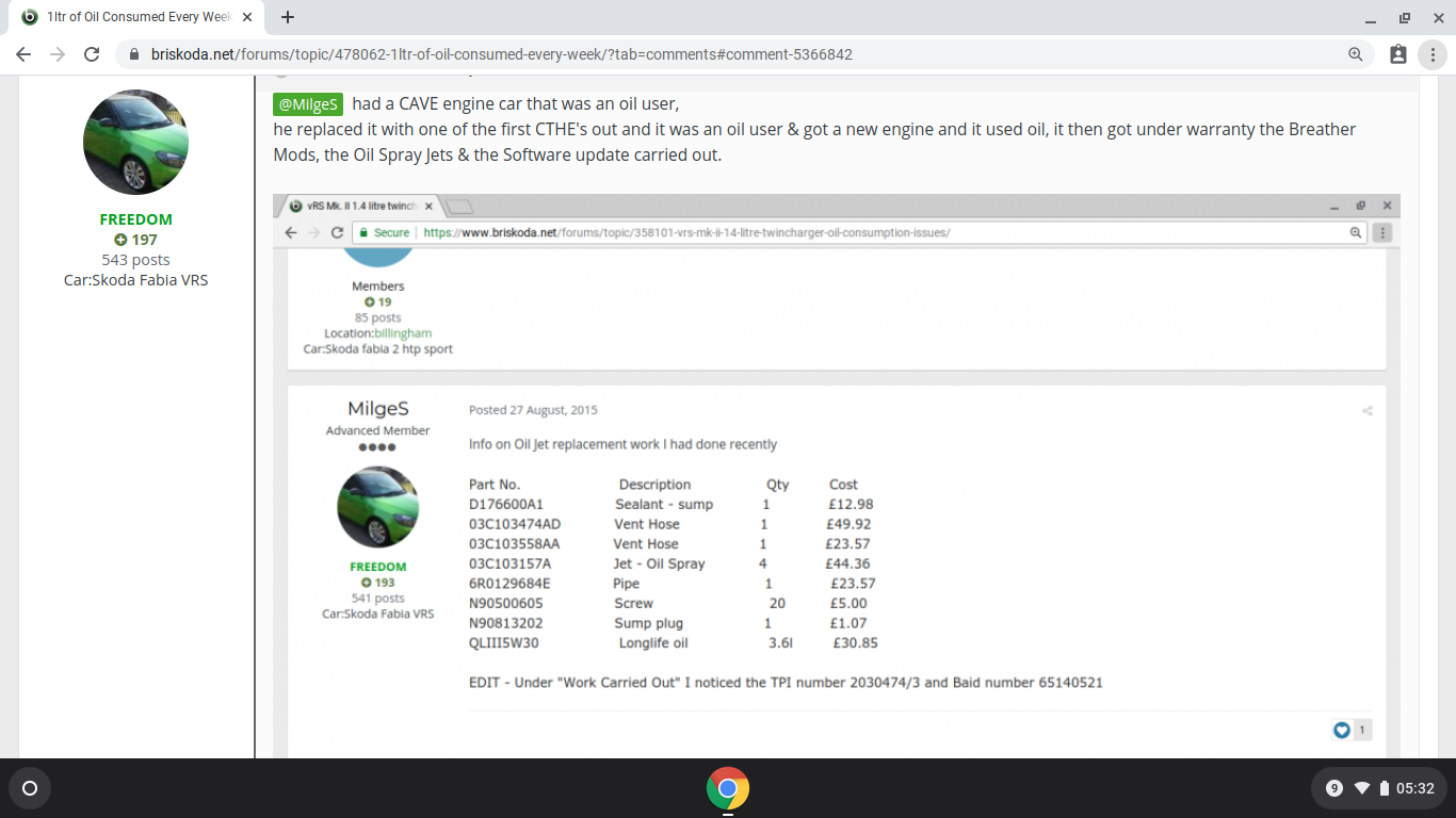

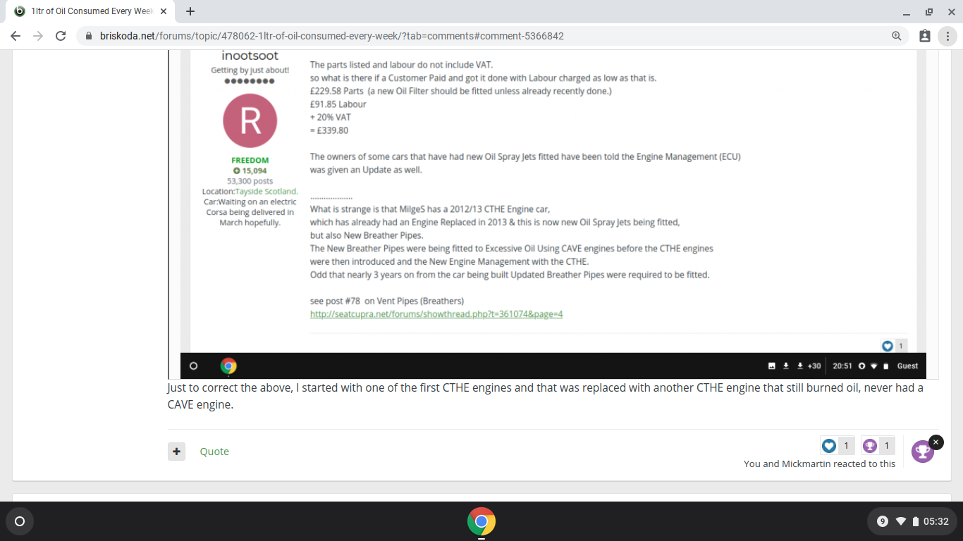

Then there is '34H5'  from 2013-2015 on the DQ200 dsg,  that is a Software Update.  That might have been what your car should have had done.
This was one of the members here to get the first of the CTHE Fabia vRS that had issues. @MilgeS
The even did Oil Spray Jets on his engine before it was then had a replacement engine.
Strange things with the earliest built CTHE's.

There were engine failures as in Rest of World with CAVE engines.
Difference is Australian Courts were able to rip VW a new hole.
**Read Lucifers Guide in the first link below if you want to read about SEAT's.
Same engines and issues as in the VW, Skoda & Audi from 2010-2012,  then 2012/13-2014.**
Software updates were being done on the early 2013 SEAT Ibiza Cupra cars by the time your car was first registered.
So if your car was built say in May then it should have left the factory with the up to date software.
(But then SEAT Dealership staff surely know if they were applying new software on cars built in Jan, Feb, March and April 2013.)

http://briskoda.net/forums/topic/358101-vrs-mk-ii-twincharger-oil-consumption-issues
http://briskoda.net/forums/topic/294051-cave-cthe-just-reply-please-if-you-have-had-an-engine-replaced
