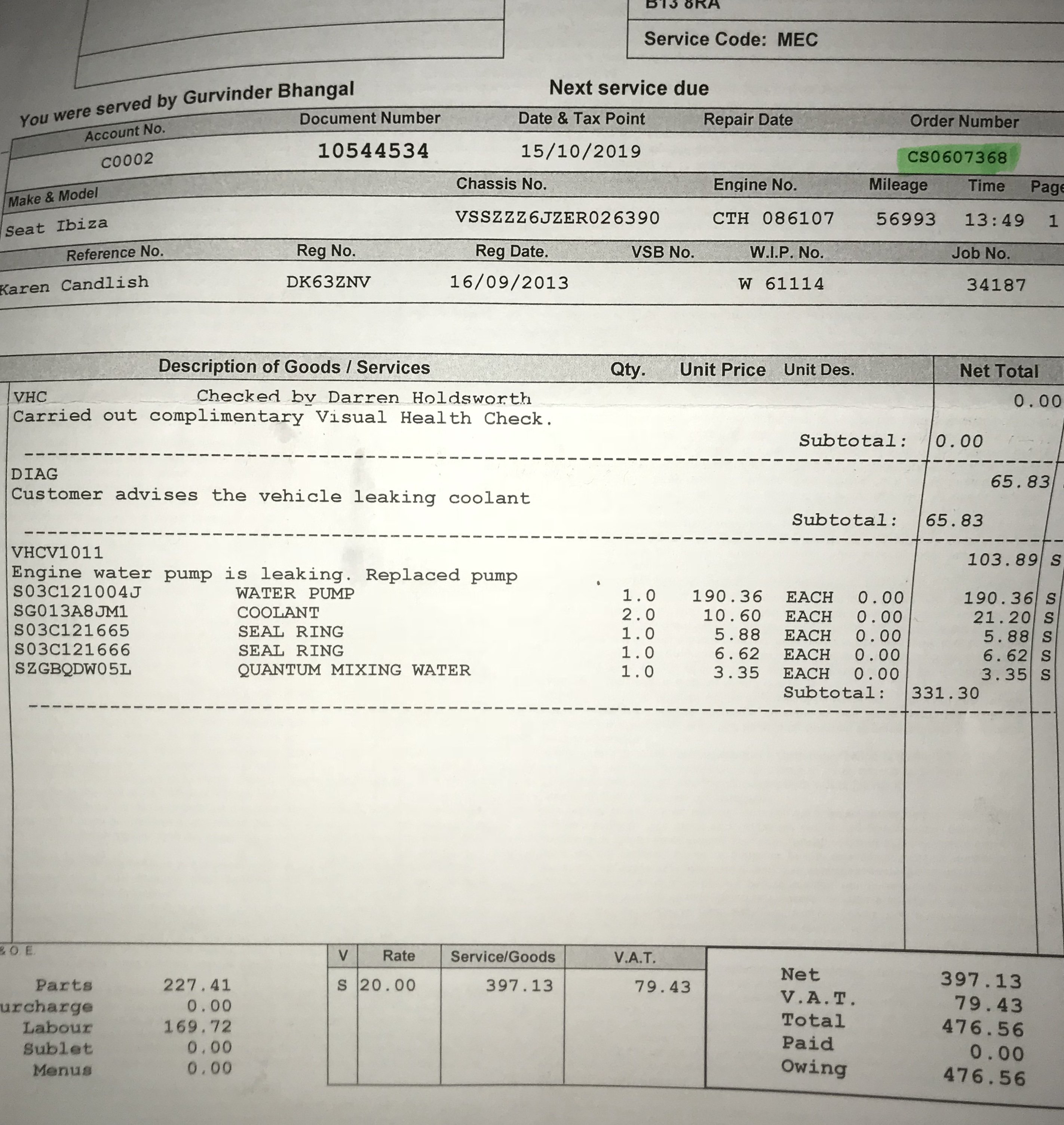

Tough situation if the place changing the water pump / supercharger magnetic clutch did not check all 4 spark plugs and you never asked them to.
What was the bill for the diagnosis and then water pump replacement,
and was that including replacing both belts?

Why would I ask them for that when they had been done last year some time. Bill was for diagnosis and water pump. No belts or anything, simply the waterpump
They never mentioned anything about any belts or anything like that

But if you put a car in for a reported coolant leak, they replace the waterpump and it leaks no more then surely they have done their job 100% correctly?
I just cannot see any connection between that and an at that time functioning but soon to fail spark plug.
If there is no recall on the vehicle for this known issue how can they have any duty of care?
