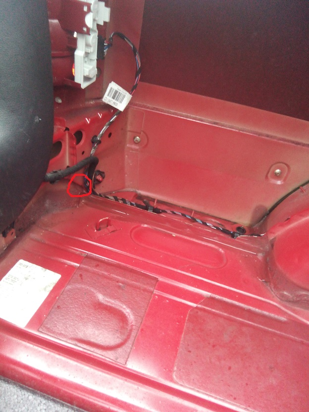

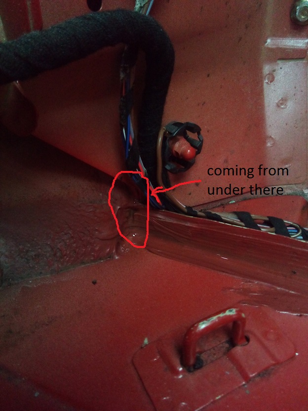

hello I found out where the leak is coming from in the boot of my 2003 skoda octavia mk1 hatchback
post-102034-0-68102200-1484509314_thumb.jpgpost-102034-0-99410700-1484509383_thumb.jpg
do I maybe have to take off the rear light or the bumper to see what is happening?
cause it´s coming from a place I can´t get near from inside
it´s the drivers side
There's loads of threads on here for mk1 boot leaks.
They leak from everywhere unfortunately!
Mines started leaking on the drivers side this time after spending weeks a few years back curing the leak on the passenger side.
Just the boot strut I think this time though...

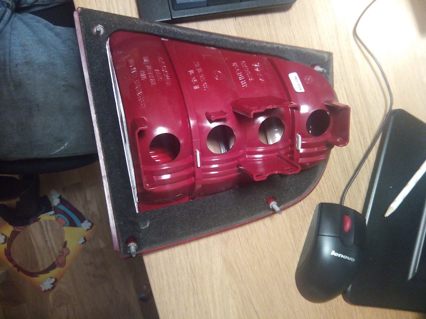

could this be the reason for the leak, when I took it off the insulation plastic was wet
can I repair it with a rubber sealant maybe?
any ideas?
Yes mate definitely seal around there. I've had these leak on both my estates now. I used this stuff http://www.autoconsumables.com/indasa-car-body-sealer-flexible-panel-sealer-grey-310ml-cartridge-2512-p.asp - but bear in mind it will remain tacky. So far, so good. Normal silicon isn't too good on metal, apparently.
I applied the stuff directly to the body of the car, making sure to go around the screw holes etc, before putting the light cluster back in place.
