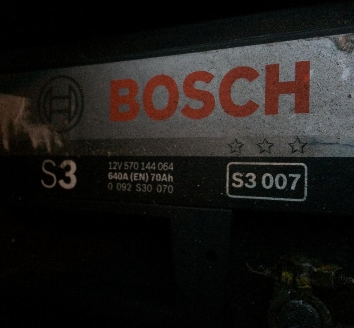

Most likely a battery issue and if it is likely to be 3 or 4 years plus probably start there.

It will not be the original battery I think, being a Bosch, so would recommend getting it charged up first and then tested.
If it has a decent charge the tester will probably be able to test the alternator too, just to be sure.
If you are lucky it has just been used unsympathetically and allowed to run down in the cold and dark weather, or it has been sat and just given a jump start to sell on to you, without charging.
If it was low on charge during the few freezing nights we have had so far, then it may need replacing though, as this can kill them.

I've attached a pic of the battery, just in case you guys don't think it's suitable.

Just to update: Took it to a garage today and was only showing half charge, decided to just have a new one fitted and starts better on the first turn, so hopefully it was just the battery and was ran down due to being turned over but not driven.
