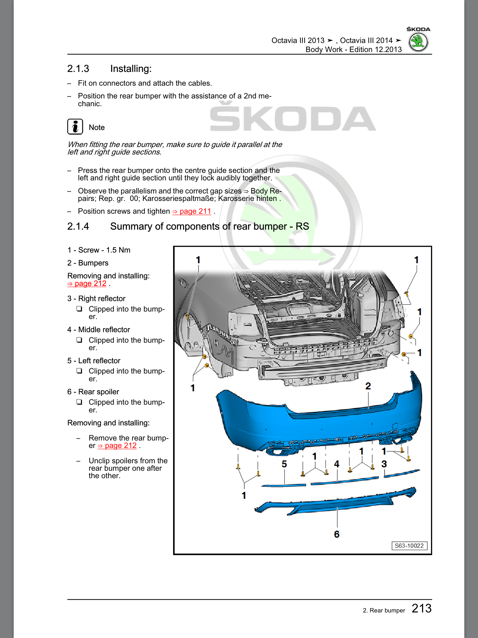

reflector is clipped in, you can see how from underneath. If it helps look in my project thread there is a how to remove the rear diffuser.
Brilliant thankyou, will need to spurce one also. Found the diffuser on superskoda for less than 50 euros. Happy days.
No problems. Once you look underneath you'll see how to remove it.

Thanks so much for the page copy out of the manual, saving it right now!
