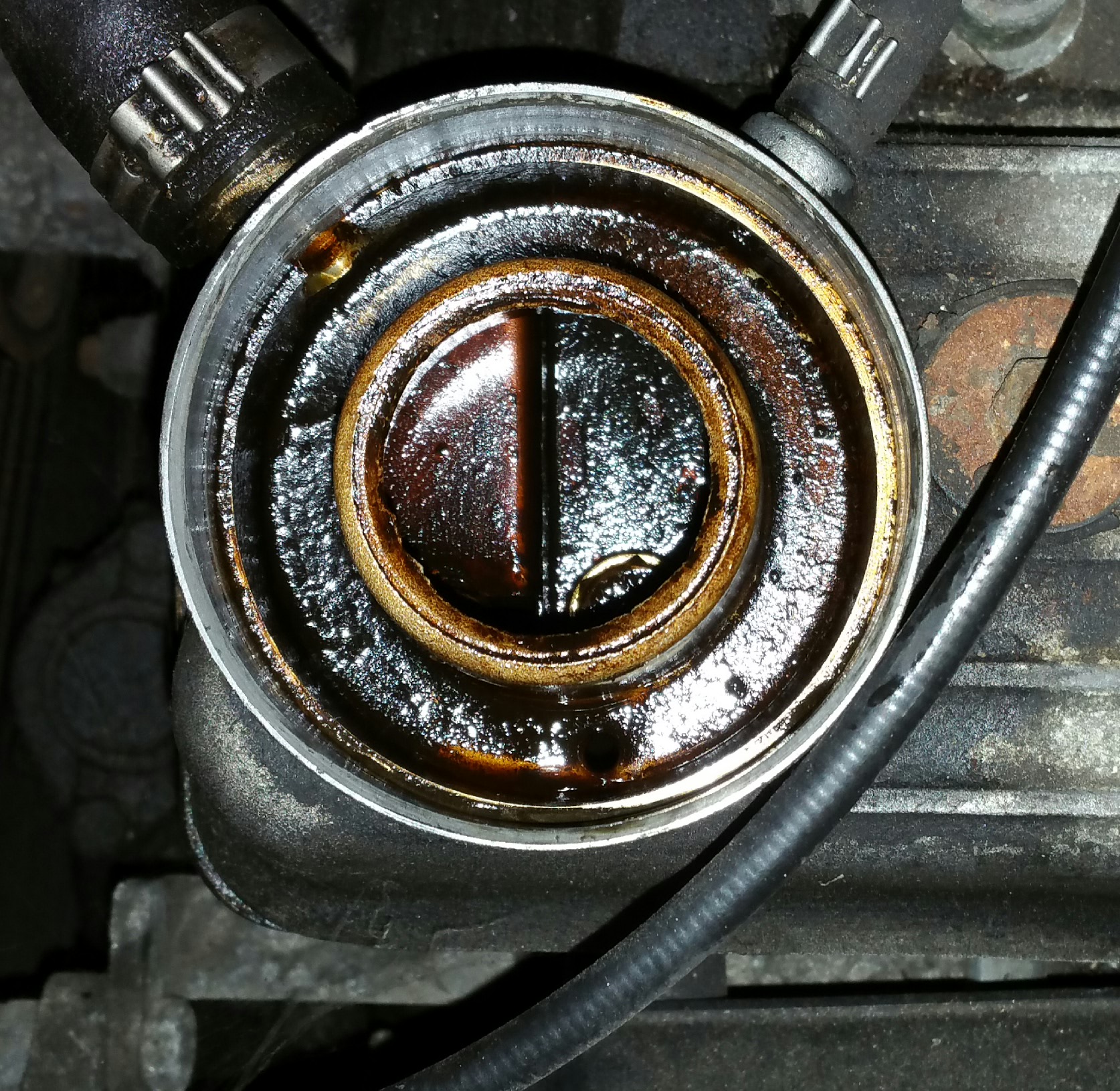

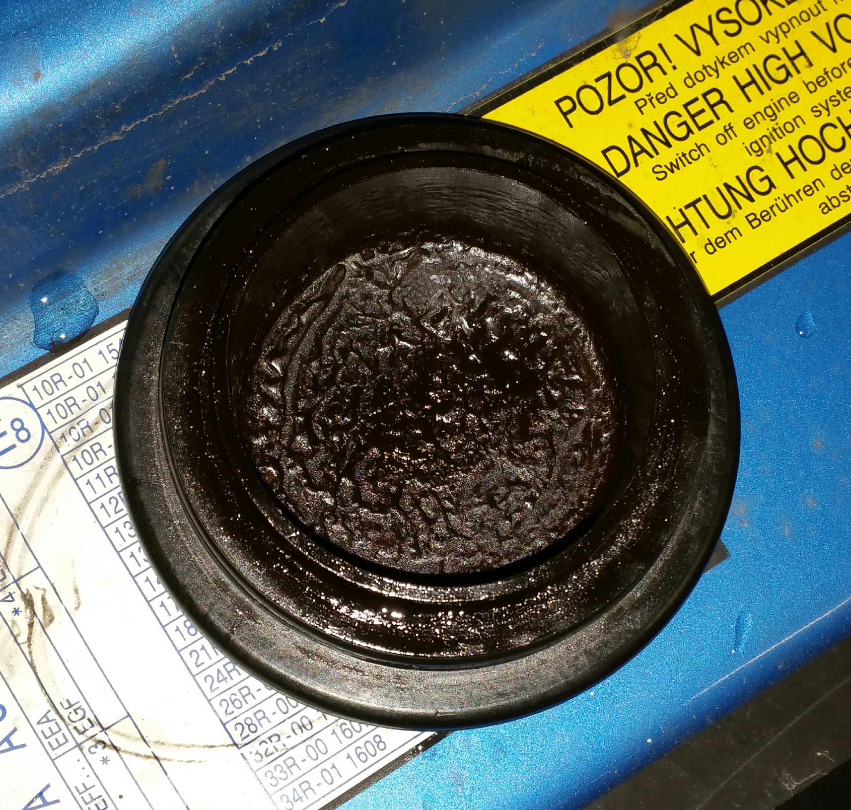

Oil filler cap is a bit cruddy but looks okay to me ( no mayonnaise ).

The photos don't show evidence (yet) of a head gasket failure. It's condensation of blow-by gases and worn valve stem seals. Nothing major yet but I'm expecting the oil level to drop faster than usual.
