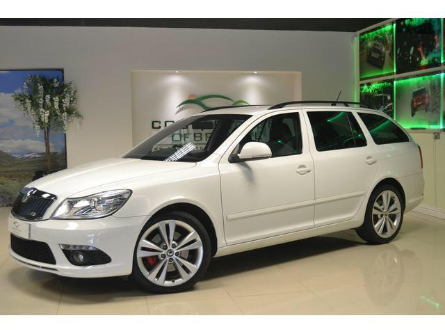

Ok lim now confused
my car is a 2011 octavia vrs cr . When I do a google search it says it's a 7 speed gearbox and doesn't need a oil change as it's a sealed unit,:@:@
When you do a GOOGLE search where are you getting that information, not a Reputed VAG Specialist like Lion in Nottingham is it??
This why I'm a bit confused
cars in for cambelt/ water pump next week at blade skoda il have to get them to check it,

Nothing to be confused at - wherever you searched will be wrong if it is a FL vRS it will be 6Sp.

Ok so it will need dsg oil change
Yep

:handshake: many thanks
more money going out then

At least the car looks very nice!  I've got a 2011, estate as well, in black magic though.
