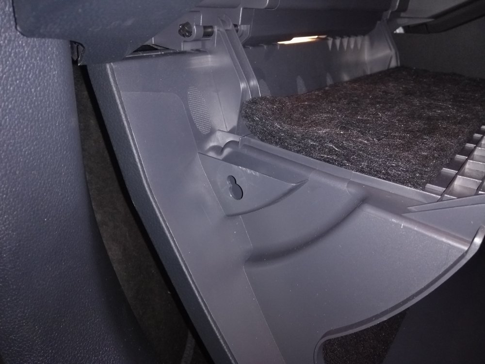

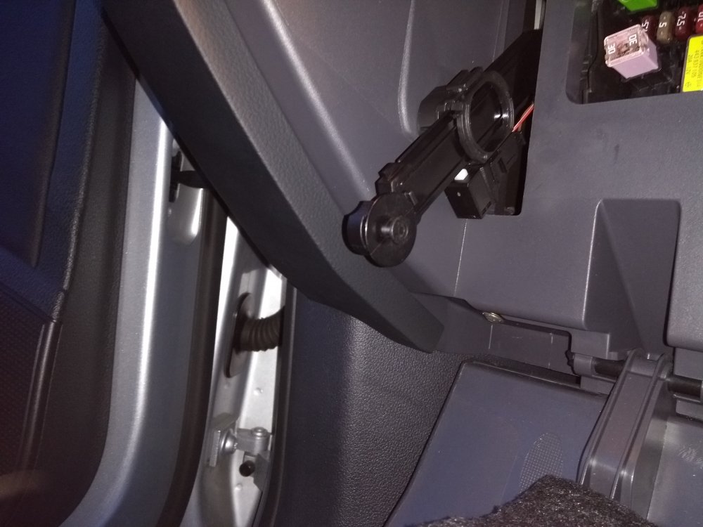

Having needed to change both my 12v socket fuses, I agree that the manual explanation is pants.
When releasing the two top tabs up so that the box can drop the whole left brake mechanism fell off from it's side retainer :(
After some puzzle work I got it back on to the side mount, align and then twist to lock. The gog wheel also fell out.
I then looked at the arm fitting to the drop down box. It's a push in\out slide type hole.
See my photos. Hope that this helps.

Very helpful indeed. The "tabs" securing the top of the box are hidden but can be felt; press on the right-hand one and gently lower the box and it will release fully ; repeat on the left. The box is now free to fall fully open and, as it does so the support arm on the left-hand side will drop out of its runners. This is not a problem and the arm does not have to be unclipped from the box - it can be left attached and fed into the runners again. As it's inserted, a "ratchet" action can be felt as it goes into its housing (the housing contains the silicone damping mechanism that allows the lid to open gracefully....)
