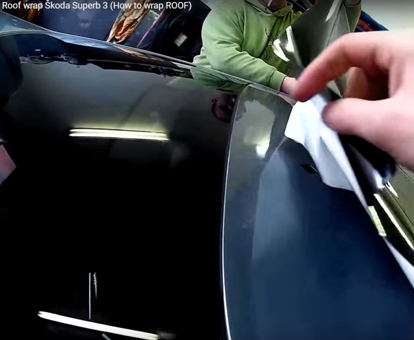

I think the screen grab from a video of an S3 getting wrap shows the ariel removed so it looks like this is the way forward.

Yes I had my roof wrapped at a local specialist. There were a lot of national companies' vans in there when I called so they presumably have a good reputation.
Anyway, yes they did remove the aerial assembly and wrapped straight across before refitting. I was there when they did the work - they partially pulled the roof lining down and this allowed restricted access to enable removal. They couldn't pull the lining far, as this would possibly cause creases. End result was first class and I've had no issues with shrinkage, lifting, or marking.
For a pukka job, the aerial needs to come off. It may be worth you trying a different specialist.
