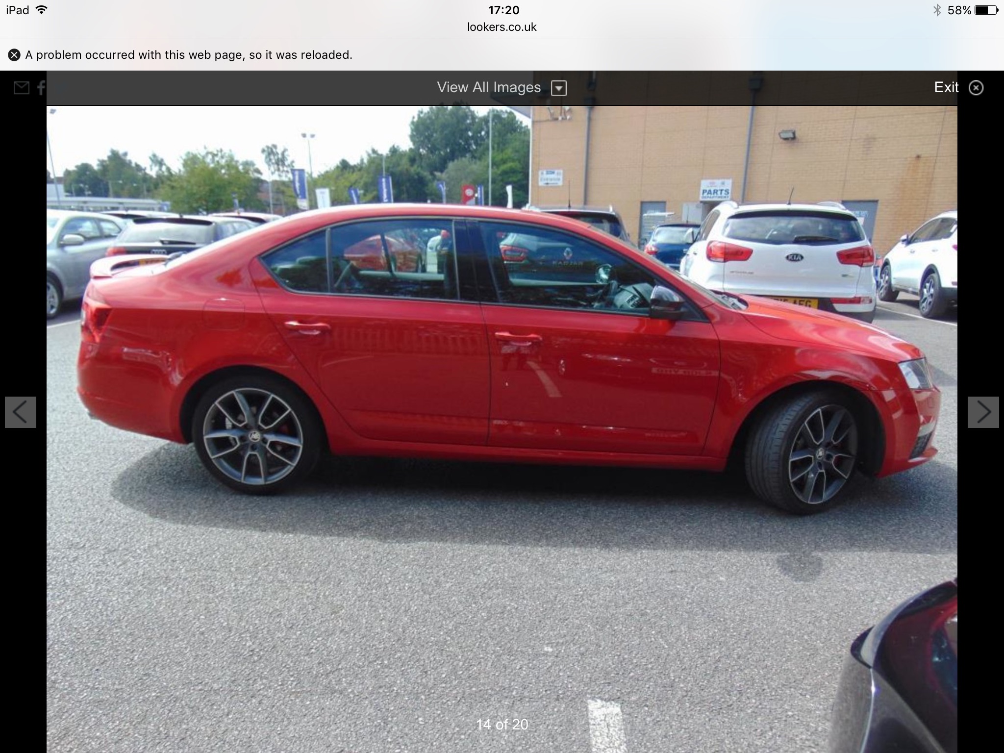

Ive attached a pic of my car (dealer photo), haven't seen many red vRS, will take and post one of my own (when it's clean)..
