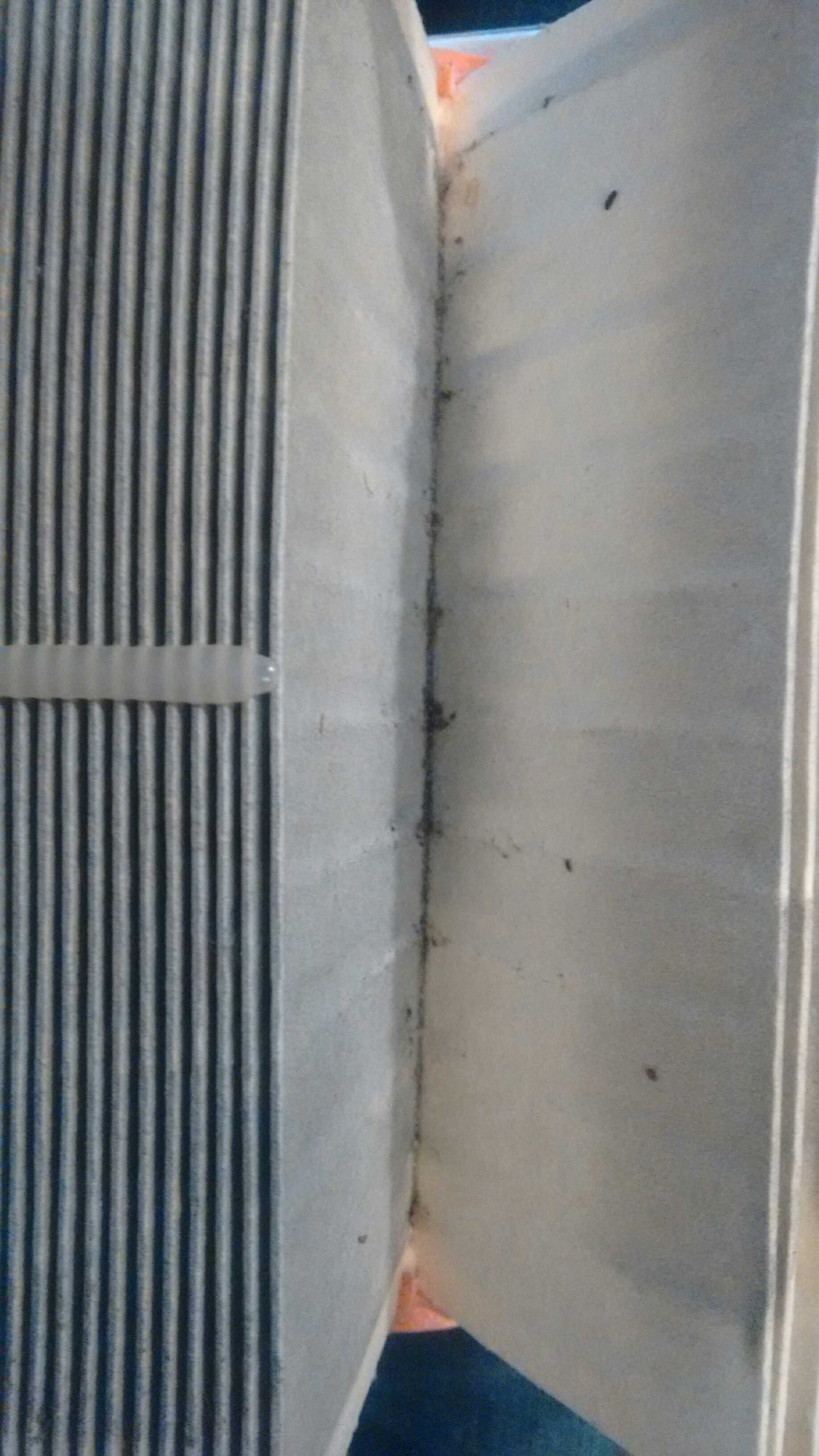

So I had a look at first thing was the leaves and debris on the underside of the filter. Yep, doing it's job, because there was straw, a whole leaf, lots of dandelion bits and other assorted cruft in there.

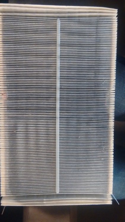

Along with that plenty of dirt and debris trapped in the filter itself.
It's not too bad and a hoover would probably have sufficed, however since I was in there anyway, I figured I might as well put a new one in (OEM paper one) as they're relatively cheap still.

Part number on the original is 5Q0 129620B (MANN FILTER - Made in Germany). The car is a 2.0 TDI CR 150
Edited by cheezemonkhai
Pictures and part number

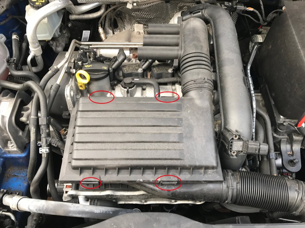

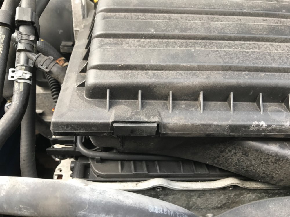

Sorry for the late reply. This is mine, had a good look over it and there are no screws. I did notice 4 clips.
I can release the one in the bottom left corner but there rest.... almost snapped my fingers off lol.

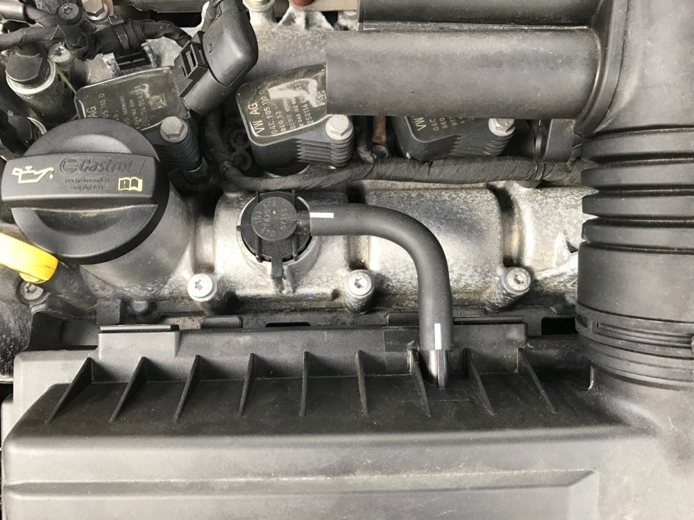

Also, there is this pipe/tube next to the oil cap which is connecting from the filter box to the engine. Seems that if I lift the top cover off then this will be coming with it.
Edited by Gazlar83
Anyone else can shed any light on opening the air filter box on the 1.4? I too am struggling to open it to replace the filter.
