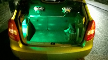

i always get a pro audio company to cut out speakers into parcel shelf, first mod and sometimes only mod i have done on cars. My VRS has had water in the spare wheel bit, not much but would'nt want any wiring in there.

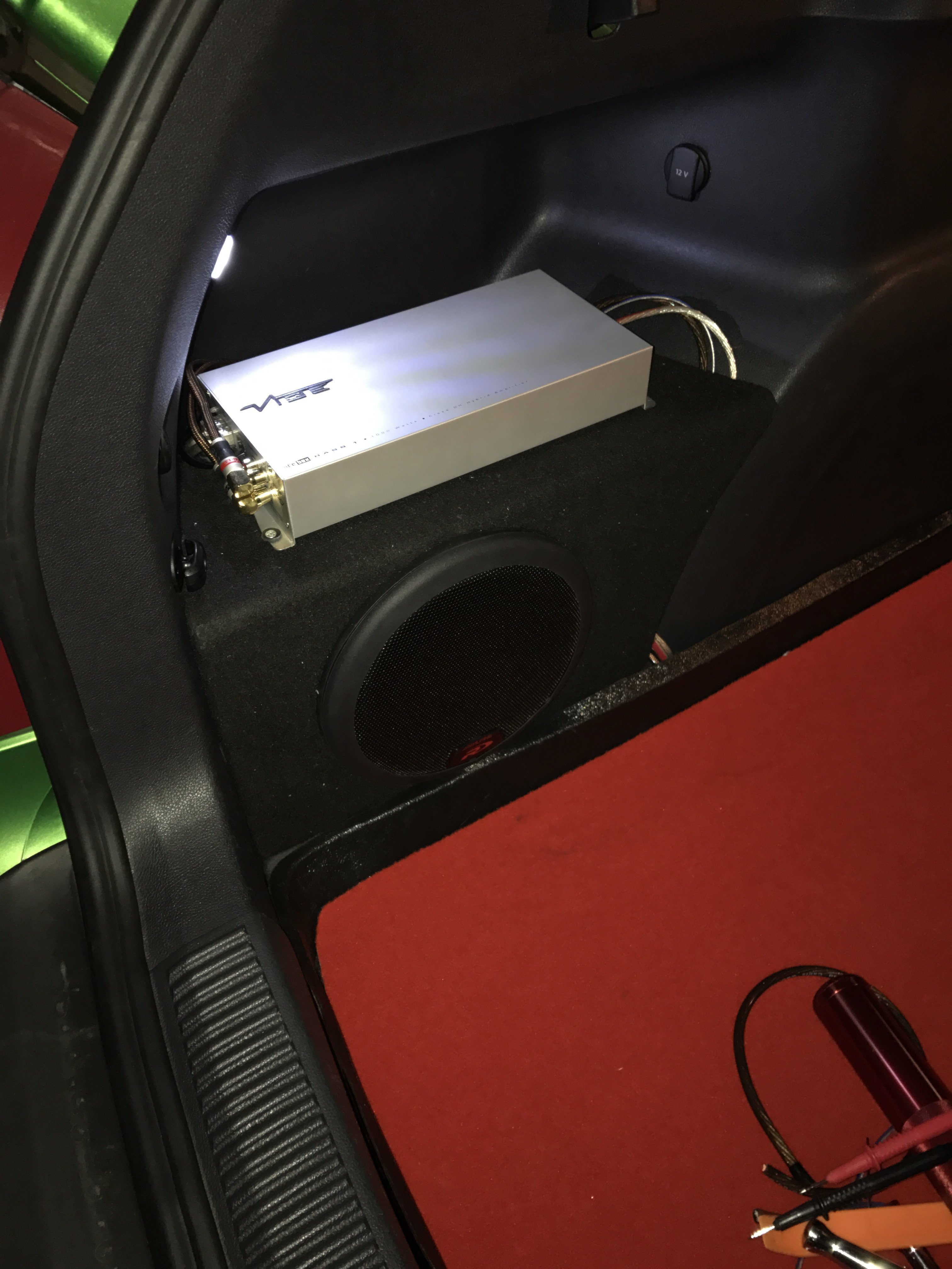

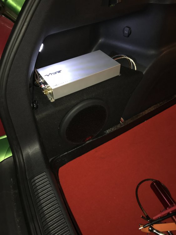

Just finished doing an install on mine-
Car has very cheap, er cack component speakers... so...
I put in single din pioneer headunit, alpine 165mm coax speakers front and rear and just disconnected the OE teeters.
I had to use 30mm mdf adaptor speaker rings- front.  18mm rear rings.  I did have to chop some of the front door card internal faces to clear the speaker cone.
The difference is phenomenal!
However, I didn't stop there- I fitted an 8" sub in a custom enclosure from fleabay.  It doesn't take up any real boot space but it is an estate.
I am now contemplating putting in a 5 channel amp to replace the sub monoblock- but that will be nuts, it's more than enough without!

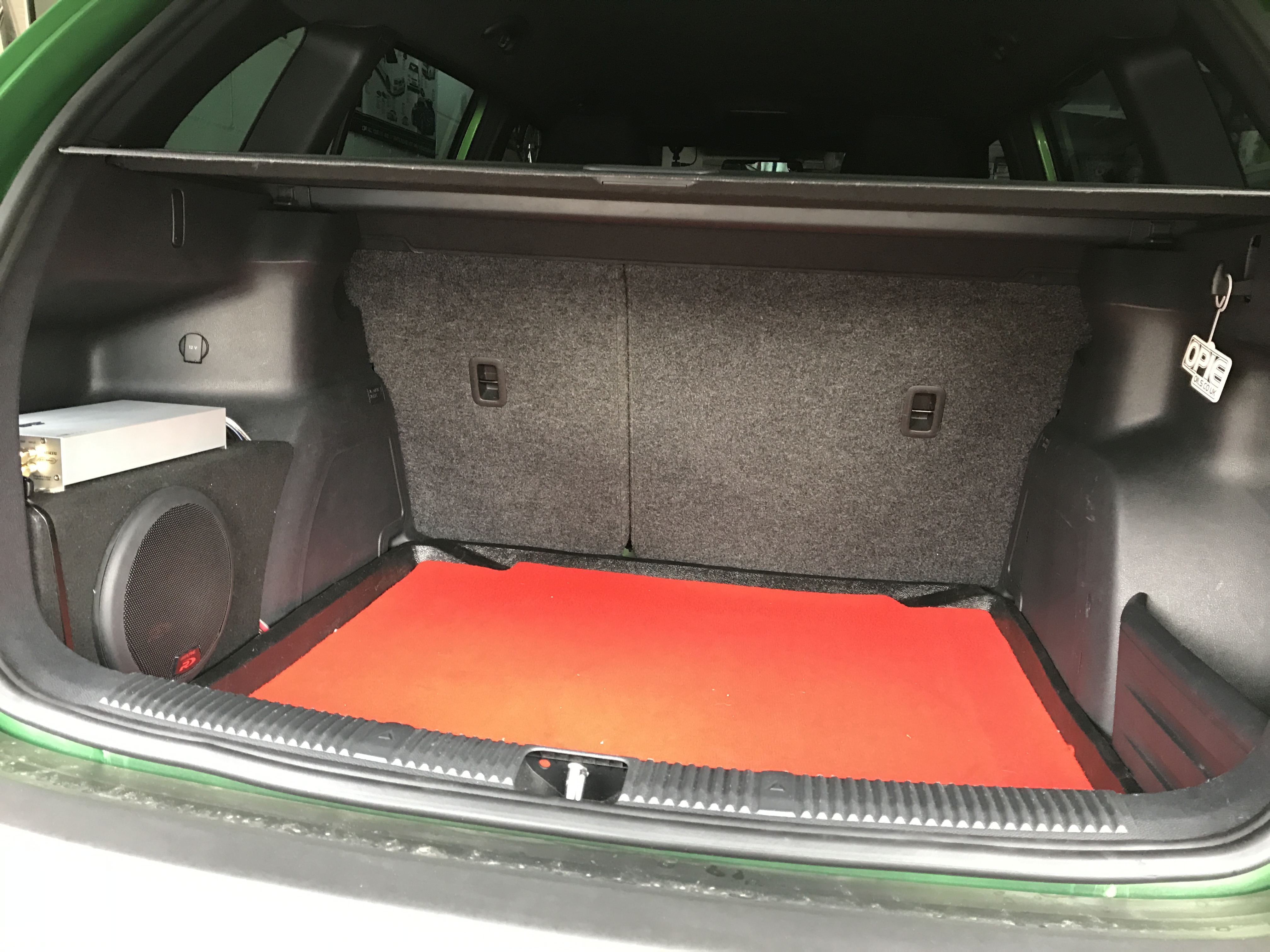

That looks exactly like the one I put in my estate, probably too big for the hatch....  Hope it isn't though!
Edited by mac26
Adding picture
I think the same one can be fitted in the hatch, just needs cutting right down and can only get 8" sub in its place
I think it is you can't even get an A5 piece of paper in that gap never mind an 8 inch speaker!
