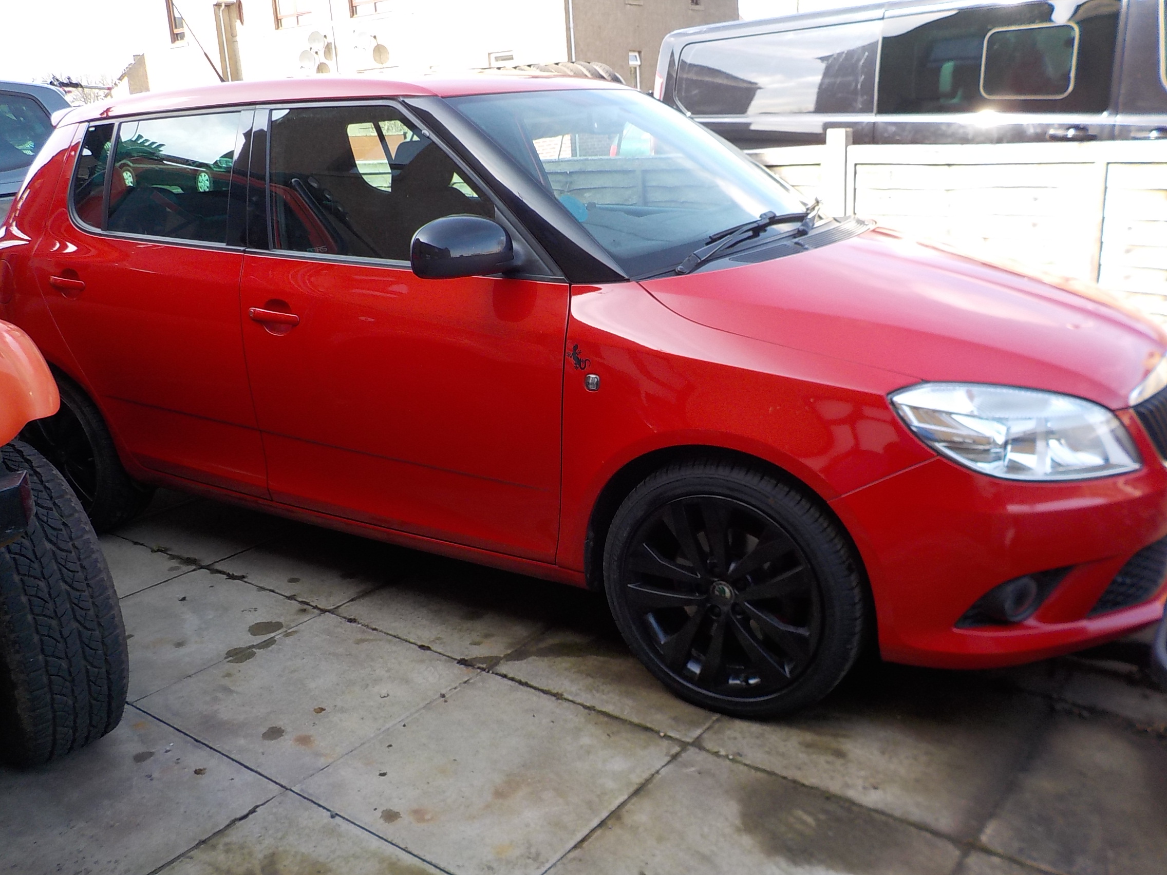

This is 205/45 R 17's on the front and they were the identical size to the 215/40 R 17 that came off.
I have run 215/40 R 17's or 205/40 R17 on the fronts lots and i keep 205/40 R 17s on the rear.
